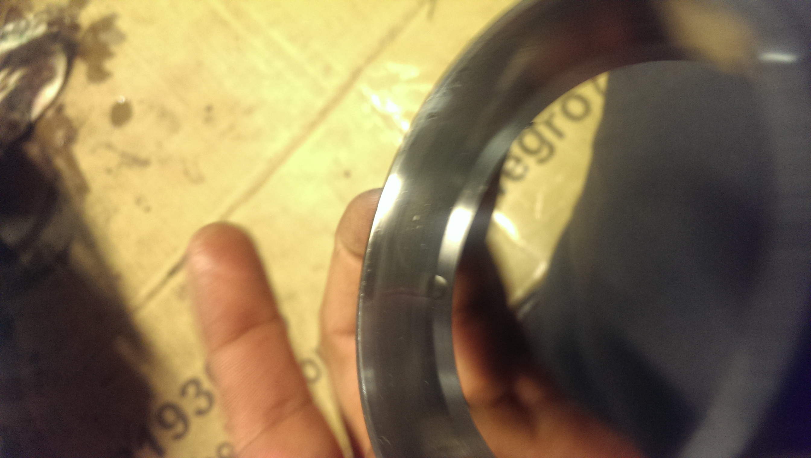

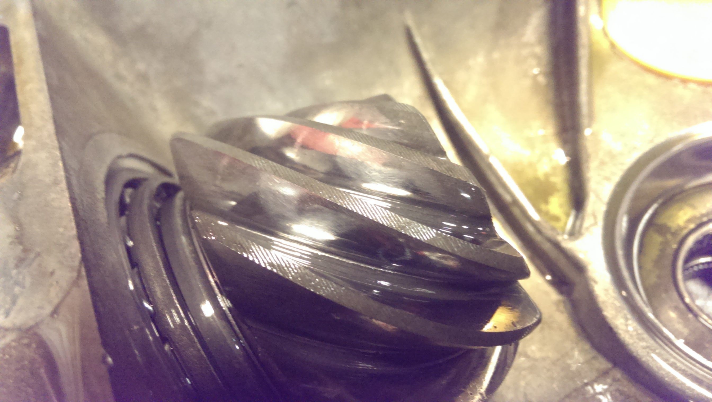

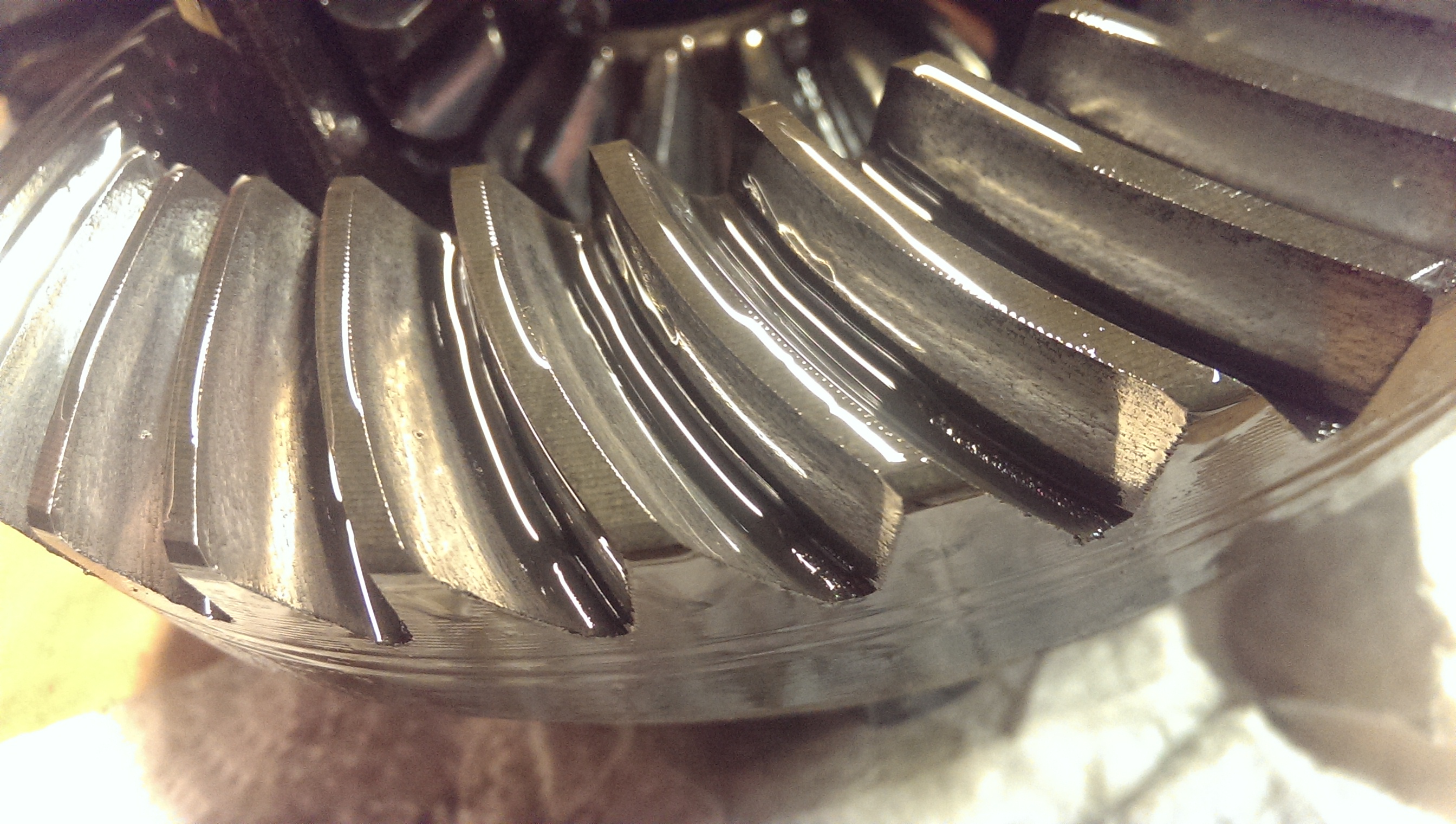

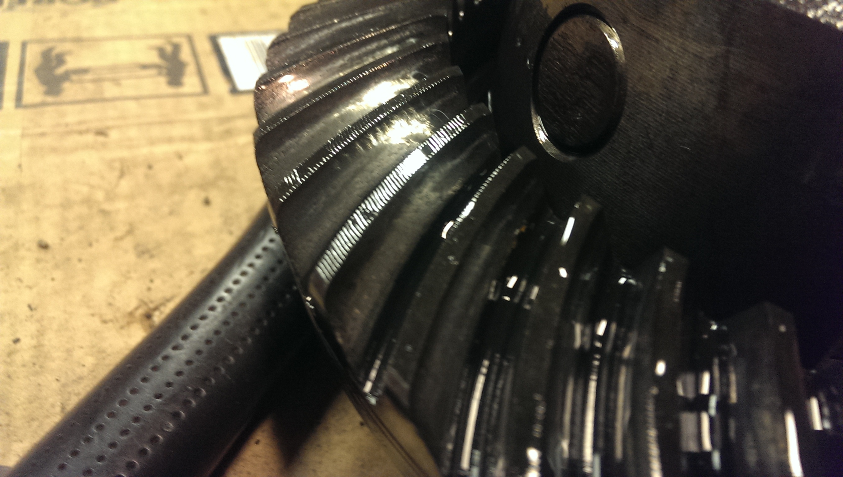

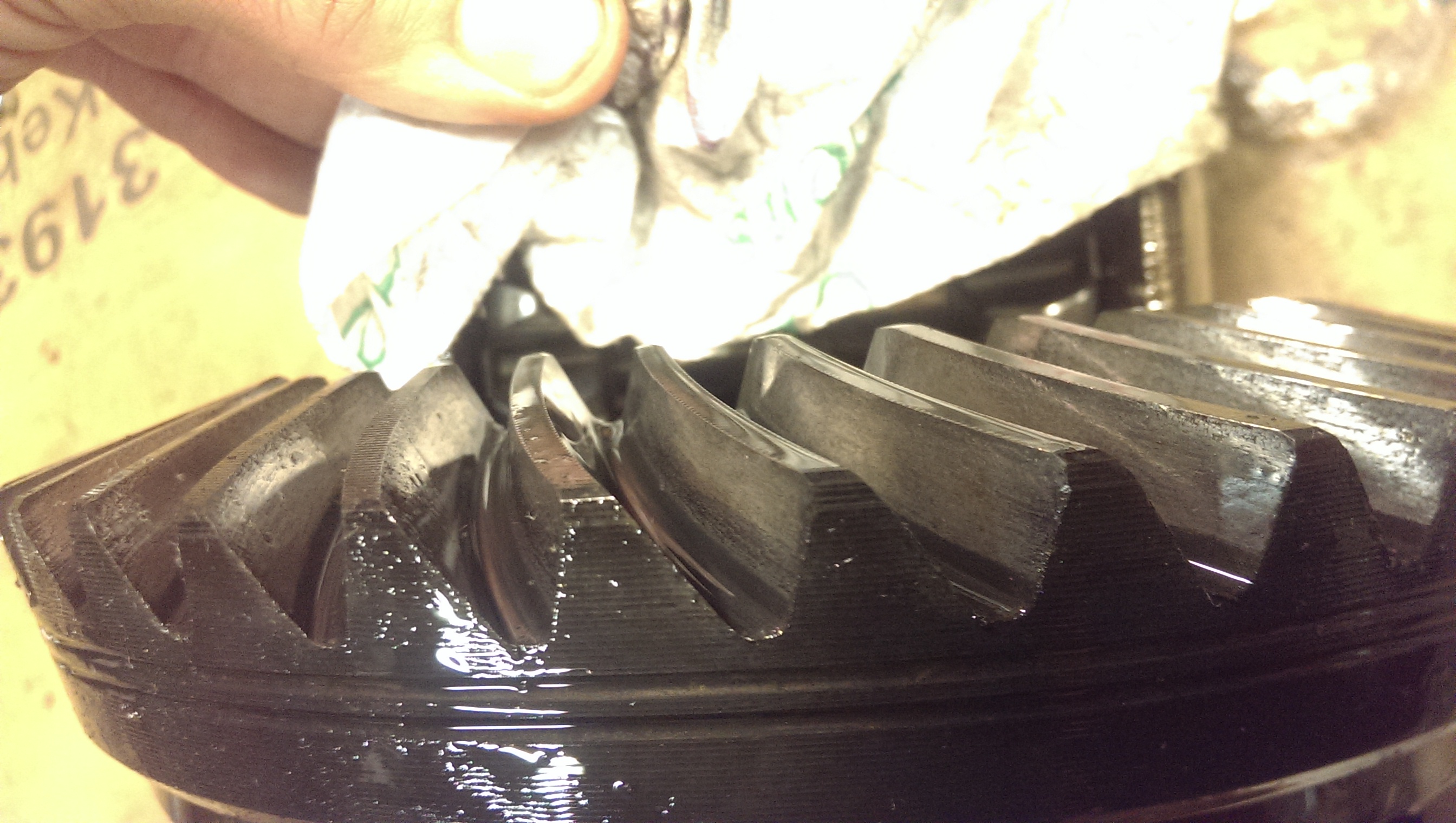

So this is my first post on here, I bought my SS in november and i started getting my first issue this past Tuesday. It sounds like clicking and clunking from the front end. Very irregular, so i ruled out CV, there was no play in the wheels so i didn't thing it was a wheel bearing. After some research found out how weak and often our front differentials tend to chew up bearings. My truck has 215k on it so i figured its probably time for a rebuild. With the long weekend coming, ordered a new ring and grear, and master bearing kit. Last night i pulled the diff, and tonight i took it apart. With the sound of the clunking i expected some carnage, but nothing!! Fluid was dark but fairly smooth with no real visible metal. Very little on the drain magnet as well.
The gears are showing some age, but nothing that would cause the noises i've been hearing. The only thing i did find, was that the carrier bearing races slid right out!!! There are some markings that indicate they have spun in the case, as well as some wear in the surface that meets the bearing. My only thought is those started spinning causing the clicking.

I'm sure others will chime in, but I think if there was any real race movement, the races would be scored or at least something visible other than a normal wear pattern, which the races and all the gears are showing...

I forgot to take a picture of the outside of the race. I'll take some when i get home. Definitely signs of it spinning to me.

Are you planning on using GM gears or aftermarket? You'll need to check pinion depth with aftermarket, but GM gears and stock shims should give you a good pattern right off the bat. I would for sure put new bearings in, since you're in there. If there's no howl or whine from the diff there's no good reason to replace the gears, unless the teeth are chipped.

I got my new bearings in, and the carrier races slide right in and out, does not need to be pressed in. They have been outside in the freezing cold all day, but i've never had something slide in that easy. I've read of people using some green locktite and hammering in a little tick in order to keep them in place.
