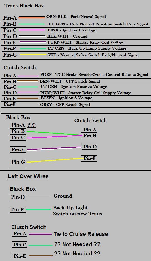

Lightbulb Auto to Manual Wiring Digram
OK, I was bored at work so, I looked through some threads and put together this wiring digram for doing the Auto to Manual swap. PLEASE if you have any input or see a mistake let me know and i will Update it!!!! Also, need to figure out if this works for all years like say 2000-2005... There are also a few wires in question that i marked on the diagram...

Great Info! It is sad that I still have not done the wiring after two years with the T56!

good to see someone put that info up like you did

Thanks, hopefuly its right... Guess I'll find out in a few weeks...

if thats wat you got of from what i posted then yea. ive driven the truck 1k miles with no issues. my cruise works like it should, everything works just as it needs to

It was put together with every post i could find about wiring for the swap...

I got under the truck last night and I finally have reverse lights after two years of being lazy on the wiring! Thanks!

the 06s are different wiring..... the starter is strictly PCM controlled, not just by the starter solinoid. tricky thing is, is has to be bypassed, but not entirely. it was like trying to go swiming without getting wet. so if anyone else does an 06, you might need to contact me lol

ok, i will change the post to read 2000-2005. Thanks! I sure hope the diagram is right, I don't want to blow out a BCM or PCM when i go to wire everthing up... :-\
