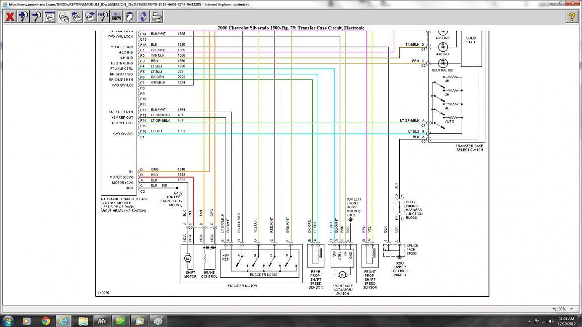

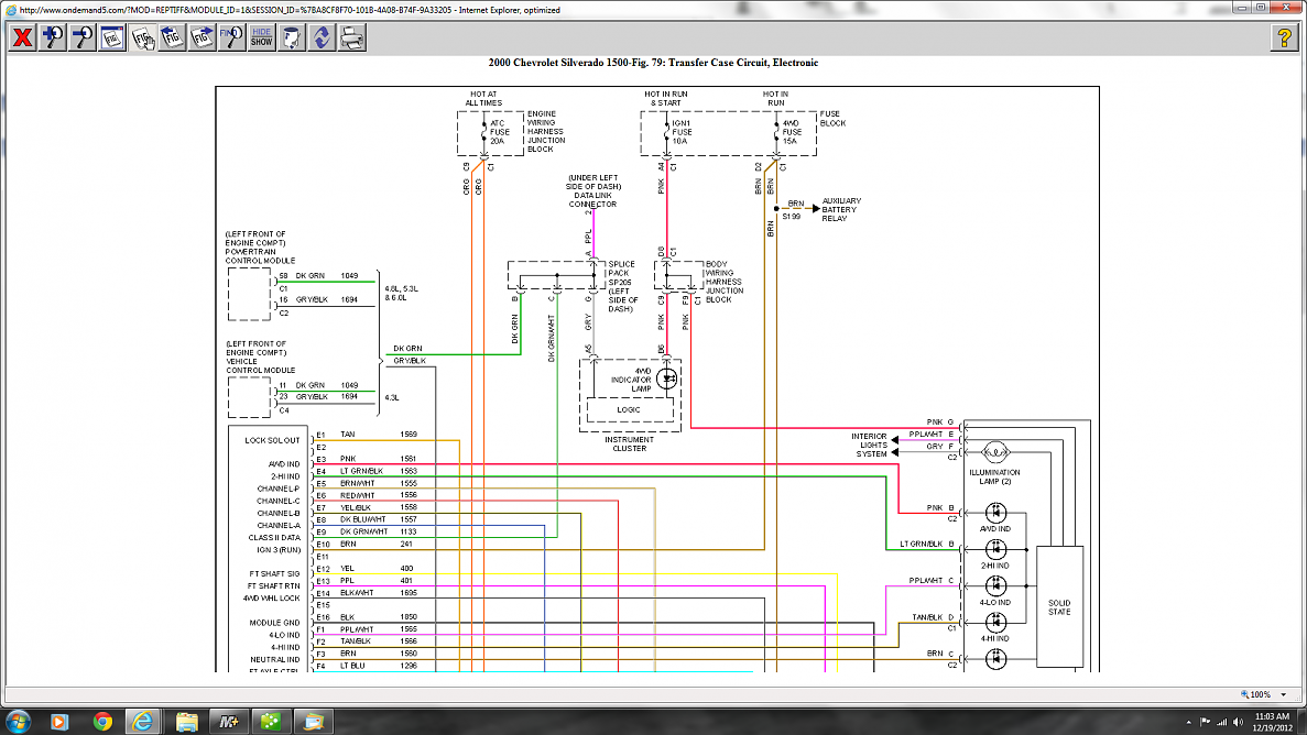

There are 2 fuses that you need to check. The 4WD fuse, and the ATC fuse(20a). If the ATC fuse is blown, sometimes the encoder motor is on it's way out, drawing too much current.
Attached Thumbnails Auto 4wd unable to select-atc1.png   Auto 4wd unable to select-atc2.png

Blown ATC fuse.
Replaced it and had him change it in and out of 4HI back to 2HI a few times to be sure it didn't blow out again as soon as the encoder motor was enabled. Went through these few cycles without problem so hopefully he's in the clear. I let him know if he blows the fuse again it'll be that encoder motor giving him problems.
