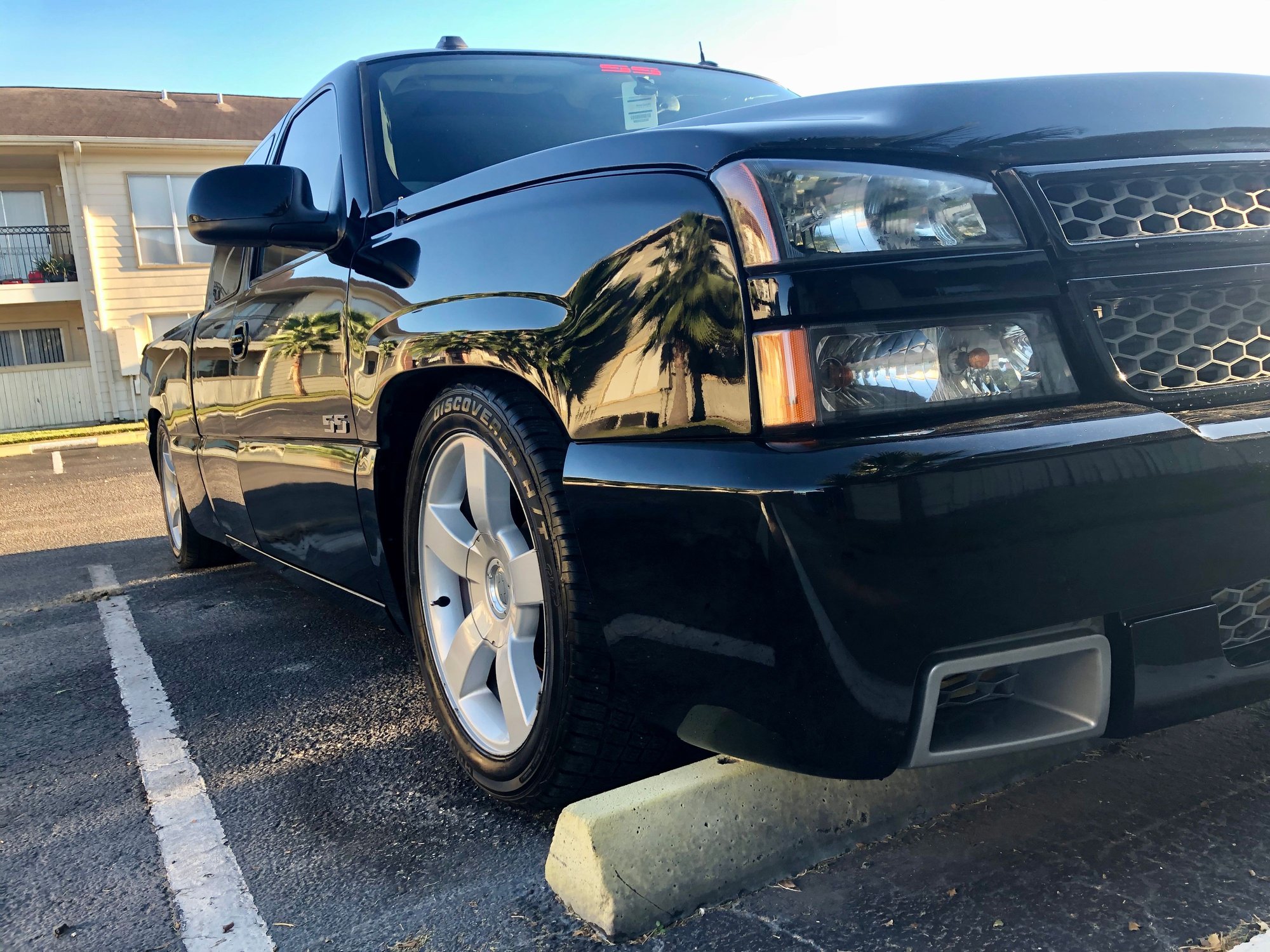

But I’ve seen this pic online.. when I was shopping for lower profile tires I wanted something wider kinda like on this pic but I couldn’t find any info on the tires on this truck.. they do seem a little wider than the 275s I run and the drop looks to be about a 4-6 same as mine... idk if the owner is on this site tho

Is it just me, or do those fenders look rolled?
