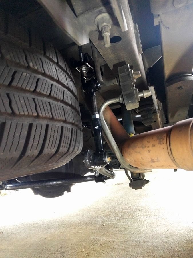

Default Hellwig 7800 Went On Fine. Love the Results!
As you can see she is on with no Corsa conflict. I used the middle hole set and its more than just a noticeable improvement.
I live near a roundabout and before I started the install I took several rotations around it for the before install felt lean.
But as soon as I took a left out of my driveway I realized the rocking boat effect was gone. The roundabout confirmed it.
It took more than 50% if I had to guess.
I am very pleased. I have the front bar arriving Thursday. Hellwig claims a 30% gain up there.
The Drivers Side
Note: On both sides the end-link to swarbar bolts are pointed the the same way. While under there it looked like it was closer to hitting the spare than it is, and on the passenger side the threads out of the nut was close to hitting the Corsa hangar so I did the same.
Also Note: The bar angling upward going back to the links. I was surprised to read in the instructions to point the middle hump downward. I couldn't tell it did that sitting in the box.
Well it's level (the middle hump) as installed and it ended up that way naturally. I tried adjusting the side bars to level but ran too short on threads. So I screwed them in the same depth as the threaded part in the links and it came out level.
I have the bar saddle brackets rocked back as far as possible without hitting lines. The included parking brake stand-off was perfect.
The connecting links lean forward a little, one reason I went to the middle hole.
The Passenger Side
This pic is tricky. It looks like the pipe hangar is close to the end-link jam nut but its not. The bolt head on the arm connection is closer. If I shake it really hard I can make it touch but a test drive on some rough stuff at speed didn't cause any contact.
So reading the instructions they say point the rear-end u-bolts downward (I had to rock them rearward) and to adjust the bars going to the connecting links to level but that cannot happen on mine (I ran out of threads).
I am not lifted. Stock Z71 ECSB.
The View From The Rear
Note:
I think it came out perfect. My truck's factory stance is the rear being a little higher than the front. With the bars going to the connecting links angling upward they match the stance of the truck.
The hump going around the differential cover in all the pictures I have seen make it look closer then actual.
