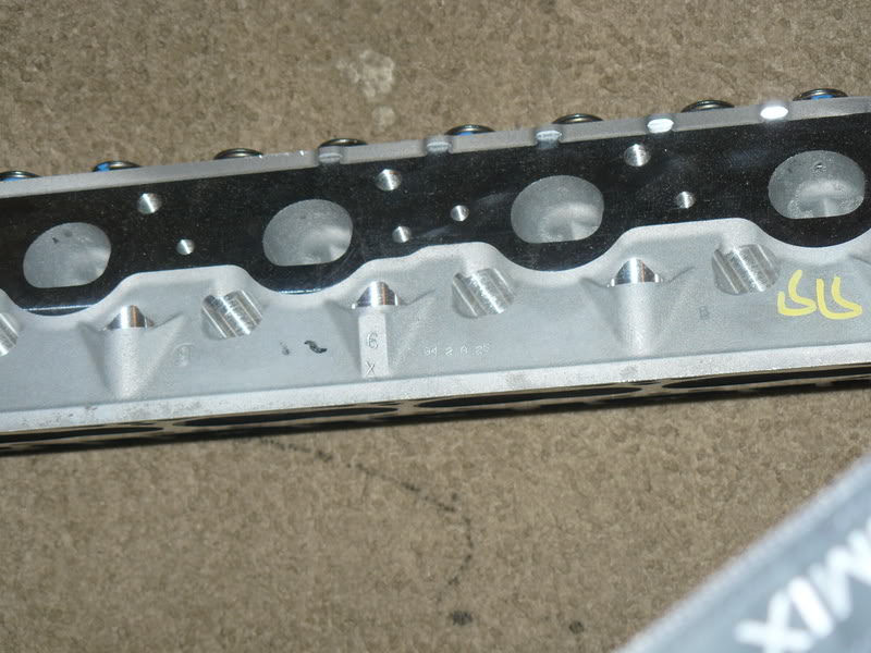

I basically want to know, how to make it work. My choices right now are the 6l80 or 90, 4l60 or 4l65. I have a local friend who has his t-56, i really dont like stick but 6 speed auto would be nice but how complicated is it to make it work behind my application and can it handle the power my motor might make. Currently I have the motor minus the wiring harness and computer, so before I go to Speartech or Street and Performance, I need to know which way to go on the trannies and computer.

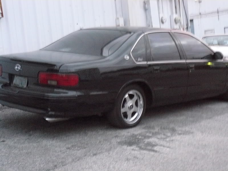

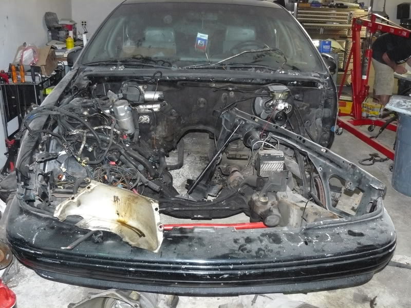

My friends impala:

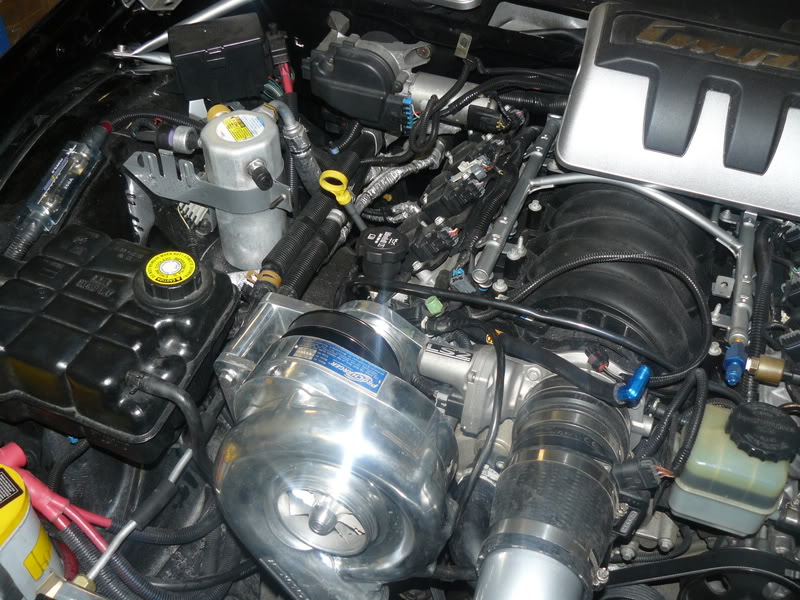

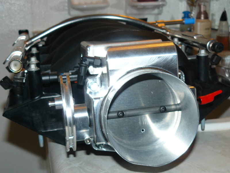

My motor out of a 06 silverado:

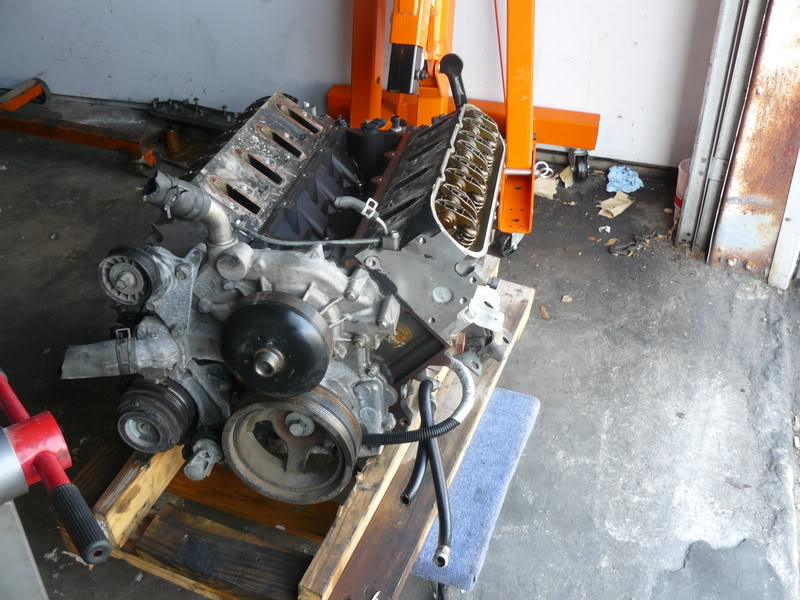

l92 heads

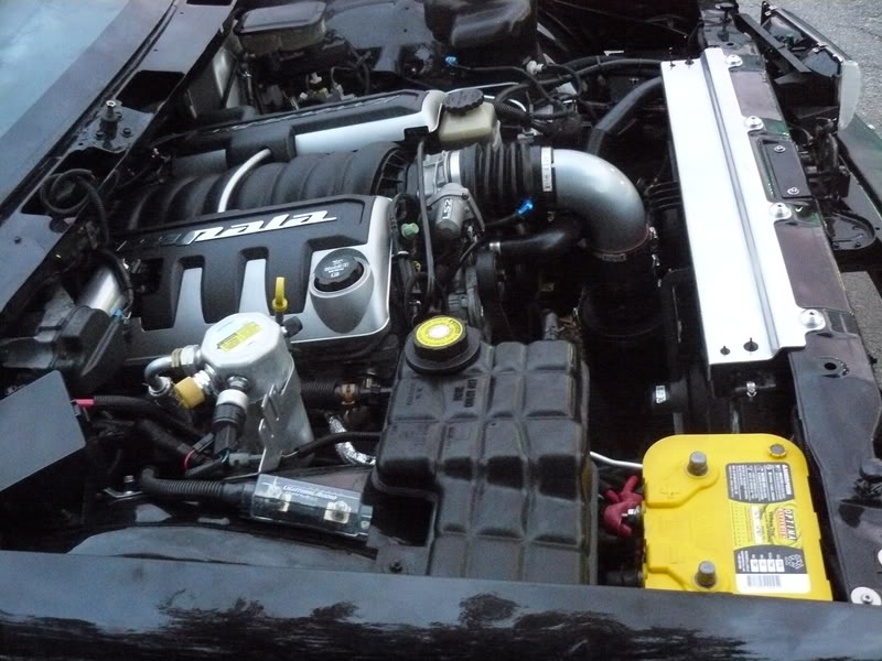

It is going into a 1995 Chevy Impala ss.
