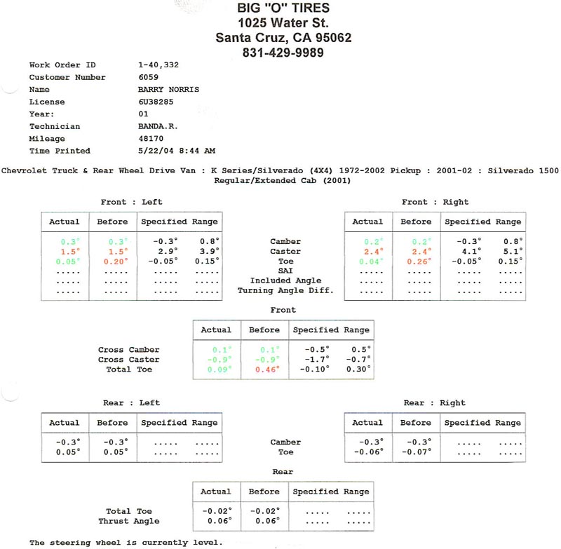

Does anyone know the front alignment specs for the SS? If so what are they? are they different from a stock silverado? What are the specs for a stock silverado? I was wondering if there is more negative camber in the SS.

Here is an old alignment print out from after I cranked my torsion bars. I got one becasue I thought my camber would be off, but it turned out to be fine.
