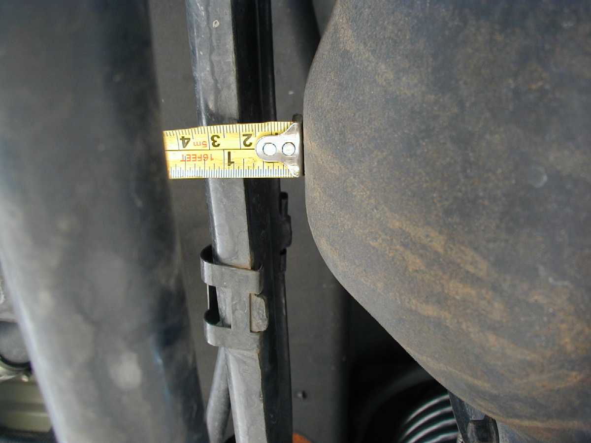

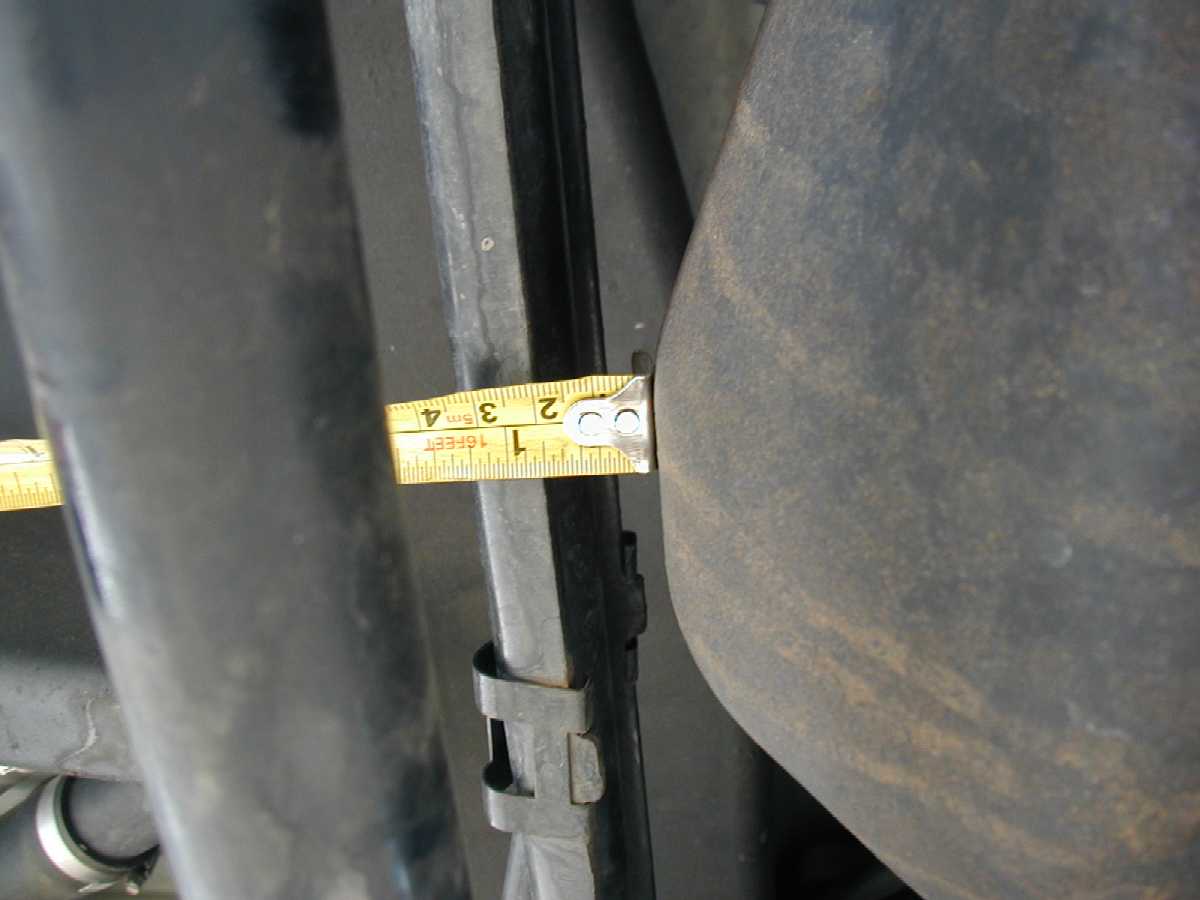

I have yet to find a solution for this problem.
I've talked with a couple of fab shops that specialize in aftermarket panhard bars, and it doesn't look good, at least for me. The most viable solution entails welding on the frame or the axle, which I will not do.
The problem is:
(1) The stock diff cover is 2.75" deep
(2) The T/A diff cover is 4.25" deep
(3) There is only 3.5" of available space
Pics illustrating the issue are attached.
The nature of a panhard bar is such that it cannot be bent, like a sway bar can. So the mounts cannot be further forward than the bar itself. The best solution is to weld on mounts further back, which like I said, I will not do.
One of the guys I am talking to is suggesting mounting his custom, rod-ended panhard bar as far back into the mounts as possible, but I don't think there is 1" of room to play with behind where the stock bar is mounted now.
So I still have my brand-new T/A cover sitting in the box.
Attached Thumbnails Aftermarket Diff Cover won't fit !!!-pass-side-view.jpg   Aftermarket Diff Cover won't fit !!!-pass-side-view-2.jpg   Aftermarket Diff Cover won't fit !!!-rear-view.jpg   Aftermarket Diff Cover won't fit !!!-tape-meas-1.jpg   Aftermarket Diff Cover won't fit !!!-tape-meas-2.jpg
