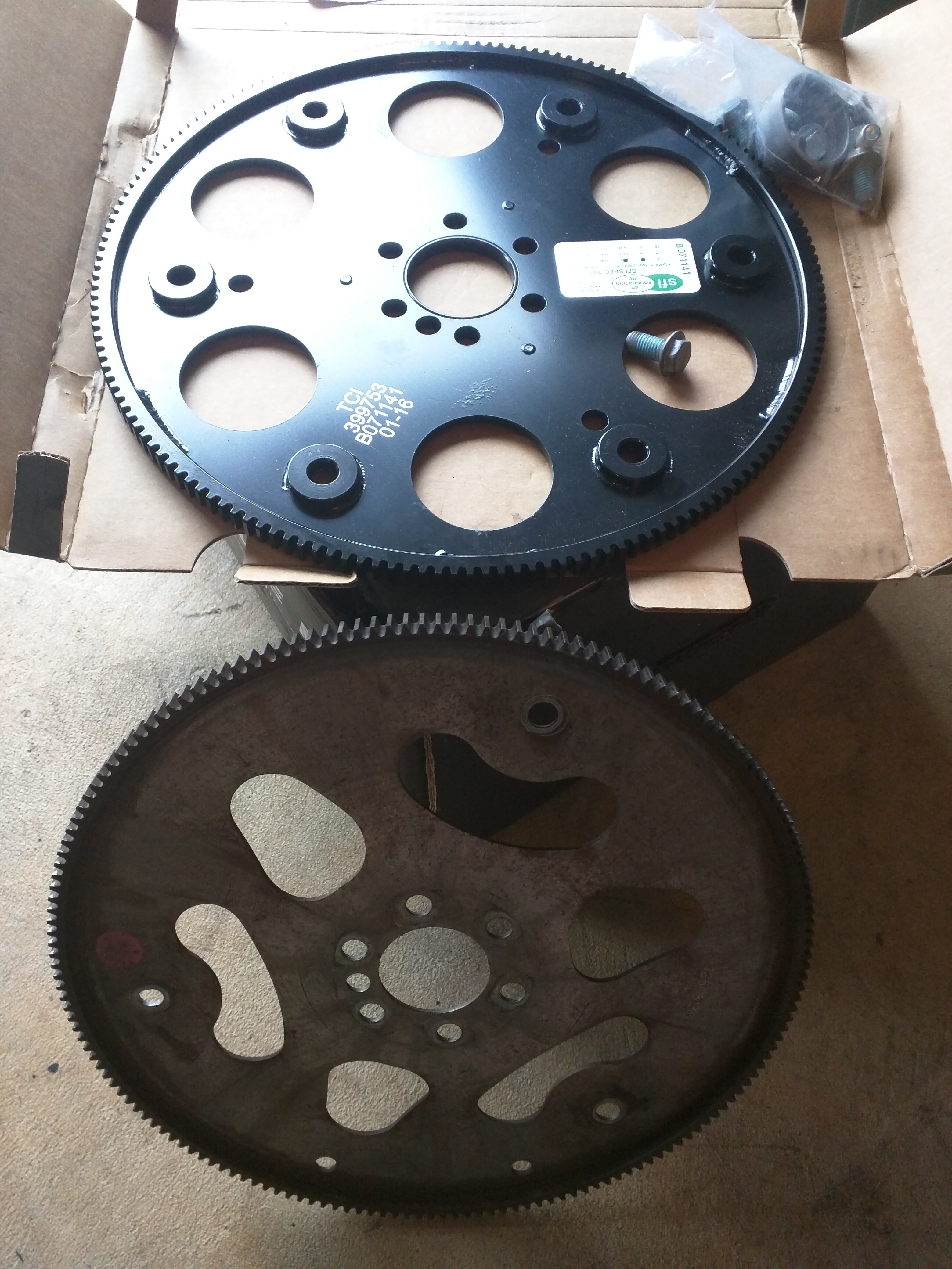

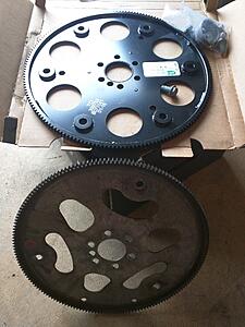

Curved? Like the one on the bottom of my pic. Thats from my stock 4l60e. The top is flat and replaces the curved. 02 Yukon btw.

Since you're doing an ls swap, the TCI I showed would probably work for you without an adapter. Its specifically for 4l60e to ls style motors. Mr. GMC beat into my head to just get rid of the factory crap if you plan to make any power. During a swap is when to do it!

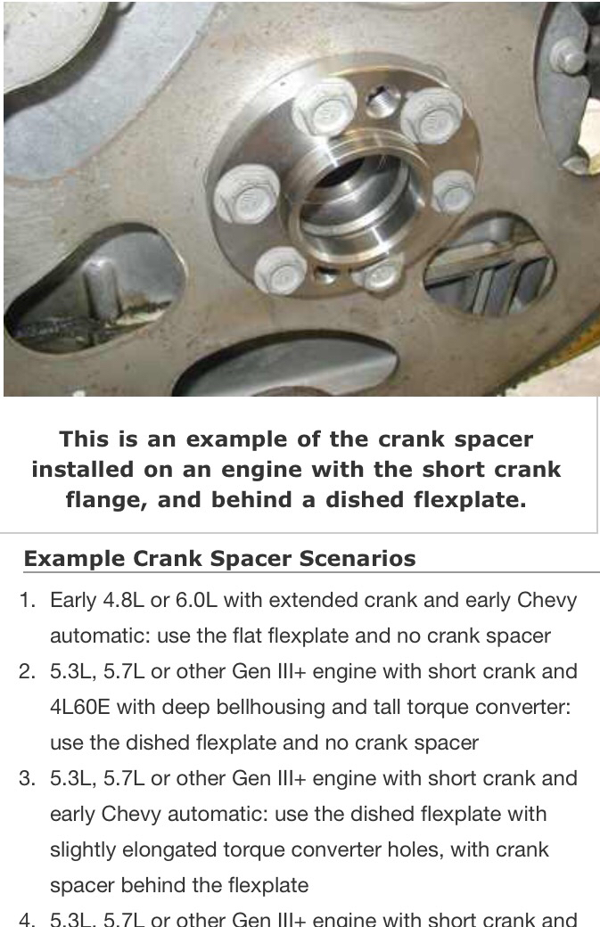

Ok, I found this. It looks like, seeing as I have a short crank and early trans, I use the adapter plate between the flywheel and converter as seen in note 3.

I might have the adapter you need. I thought I needed it and didn't. I'll give you a great price if you give it a good home.
