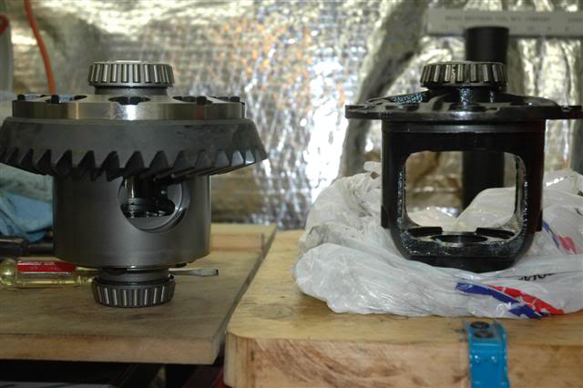

No matter which clutch preload you choose, you will be getting a much stronger rearend than the stock open or stock G80 rear. Much more metal on these. Same goes for the Eaton Detroit Truetrac.
Trutrac vs. stock open dif.
