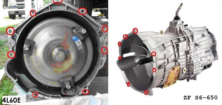

Determine which Transmissions will fit the 5.3L
ALL the motors in GM’s line up for the full size trucks have the same exact LS Series Bell Housing bolt pattern, even the Duramax!!! So, you can bolt up any of the Manuals to the 5.3L motor with out a problem.
*LS Series Bell Housing mounting points seen here marked in RED.
Attachment 139591
Attachment 139592

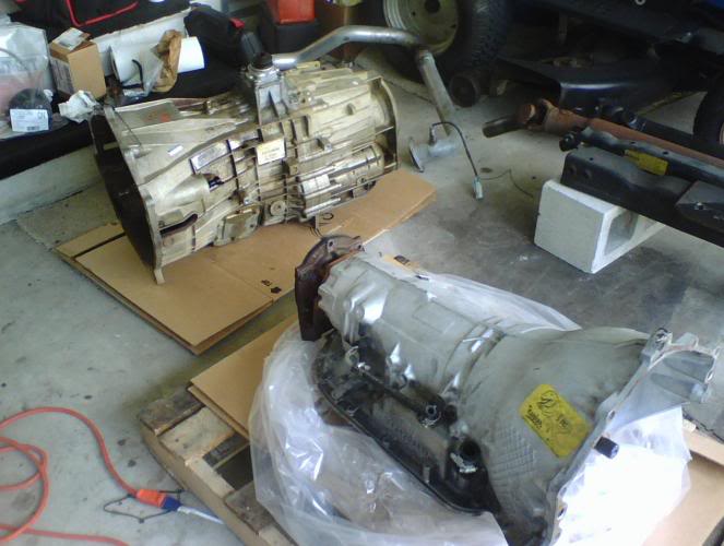

The ZF S6-650 is rated for 650hp up to 26,000lbs GVWR! It’s big, it’s heavy, its made to take a ton of abuse and its just plain badazz! There are guys using stock ZF6’s for Sled Pulling in their Duramax Silverado’s making over 800hp and 1,400lbs of torque towing upwards of 20,000lbs! I think it can handle my ballsy little Turbo Charged 5.3L… To give you an idea of the sheer mass of the ZF6, the 4L80e and NV4500 weight in about the same at a hefty 185lbs w/out fluid. The ZF6 weights in at a staggering 240lbs w/out fluid!!! The overall case size is larger too and the gear sets are massive…
*Seen here are the ZF S6-650 on the left and the old 4L80e on right.
Attachment 139593
*Seen here is the ZF6 next to a cordless drill for size comparrison.
Attachment 139594

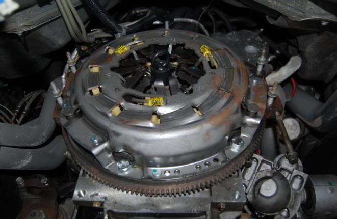

Flywheel and Clutch: The ZF6 will bolt up to the 5.3L motor thanks to the LS Series Bell Housing design but, you need a Flywheel and Clutch for it. The 8.1L and Duramax have a different Crank output on the Motor so can’t just use a full set from one of them. And the Splines on the ZF6 Shaft are larger then the NV4500’s so, you can’t use the clutch from the 6.0L set up either…
Enter Ace Clutch located in Sanford, FL, these guys know their stuff and got me set up. Simple solution, use the Flywheel for the NV4500 from the 6.0L. Mate that to the Clutch and Pressure Plate for the ZF6 from the 8.1L/6.6L and you’ve got Fun times ahead. Yes, these parts all bolted together like they were meant to be… Oh and unlike the T-56 Camaro setup that uses a girly 10 inch clutch, this set up uses a manly 12 inch clutch. And to top all this off, I also opted for an Upgraded Heavy Duty 8.1L Towing Clutch/Pressure Plate combo for even more clamping force.
*The Clutch assembly installed onto the 5.3L
Attachment 139595

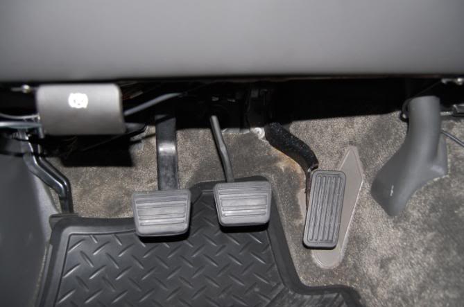

Installing the Other Parts…
*Seen here is the new clutch pedal and cut down brake pedal.
Attachment 139597
