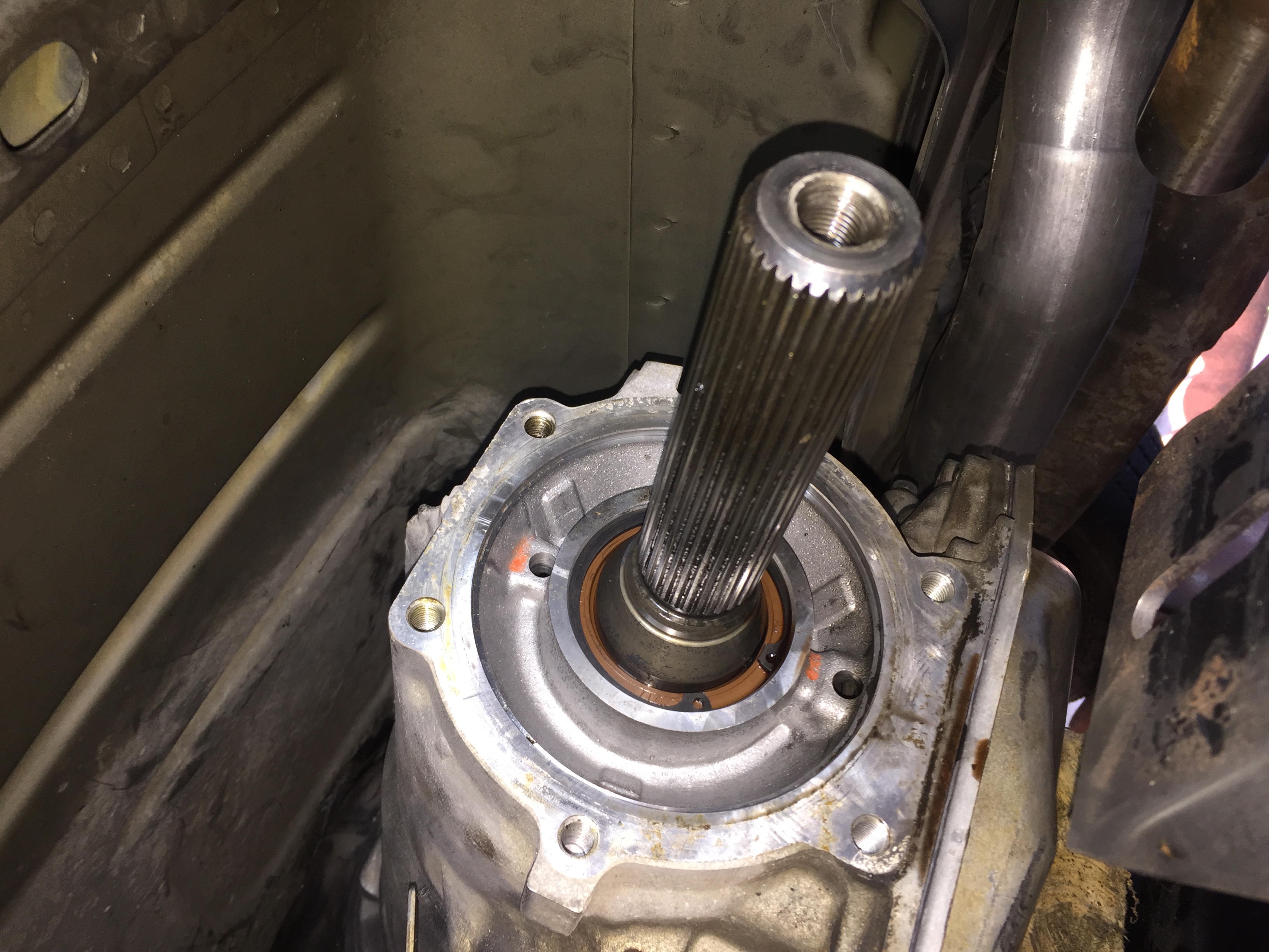

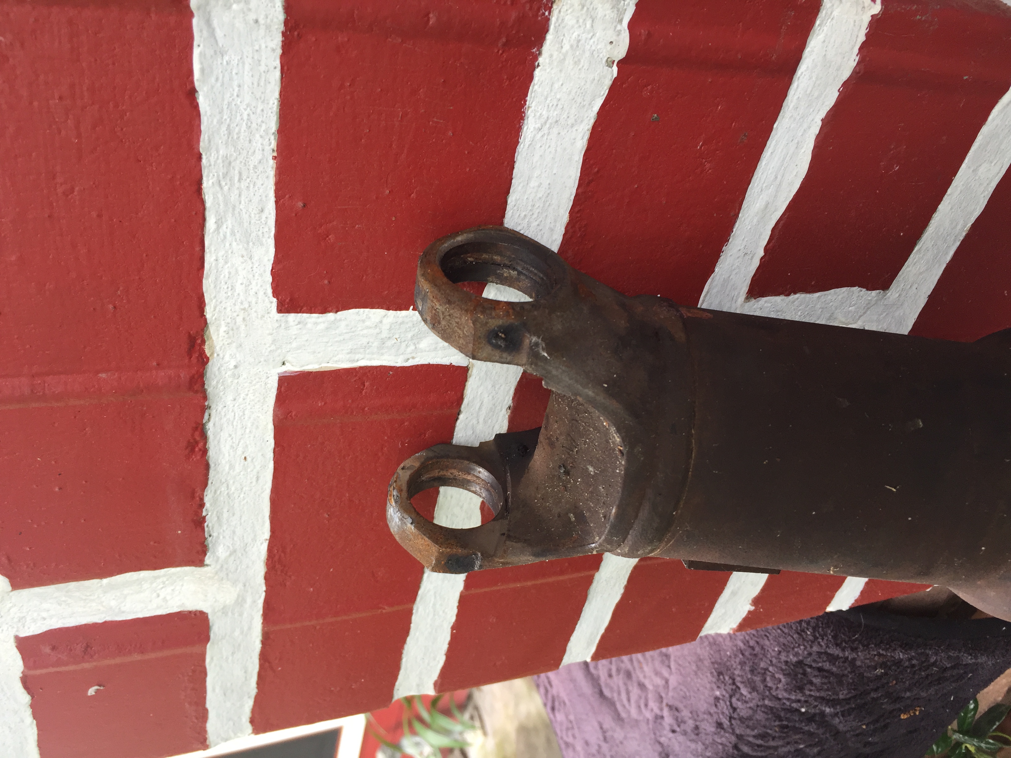

Witch slip yoke would I need for my 4l80e swap on a 2000 GMC Sierra rcsb .The output shaft has a threaded hole in the center so would I need the spicer 2060108 or would I be fine with the spicer 3-3-5571X. And would the 447 moog or precision u joint fit my stock driveshaft?

What size up joints are on your drive shaft?

Its either a 3r or 1350 . Do U know how to tell exactly ?

Since I had 1330 joints on my DS I went with this one
p1536_t_400_4l80_4l85_transmission_slip_yoke_for_u se_on_truck_tran.html
Dennys Drive shafts has a wide range to choose from. I'm sure they can help.
