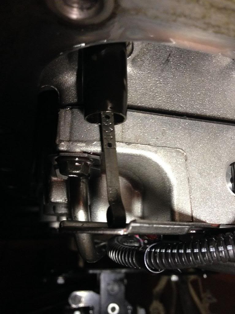

here is mine, so anything from the top hole to just maybe 1/8-1/4 over that should be ok?
4l80e tube
stock 05 4l60 dipstick

Hard to tell from pic but where ever the valve body meets the case. Everyone I have done has been 1/2" above full for the new hot F.

well i thought it was because of useing a 4l80 tube and 4l60 dipstick.
from my top mark is only maybe 1/8-1/4 to where the valve body is bolted up, so i figured if im at the full mark im doing good

Whenever I put my pan on, I marked the dipstick right where the pan meets the case. Can anyone tell me how much higher up is it where the valve body meets the case? Trans is an 01.

I wanna say its the same but dont hold me to that, I am trying to remember. Not home and dont have access to a spare to check.
Should be correct. The pan rail and the VB surface are machined all at the same time.

From my perspective the tube and dipstick hashes are irrelevant. After trans install, pull the pan off with the tube and dipstick installed and mark the dipstick at the level of the interface of the case and pan. This is the new "full" line. Some even advocate 0.5 qt over this mark. This is an absolutely critical aspect of install. I've read people speculate the reason GM put the full mark lower was to avoid the trans puking fluid and starting a fire. A stock vehicle won't see the G-forces a heavily modded one will hence no issues with fluid starvation with the lower level.
Awesome, I am good then.
