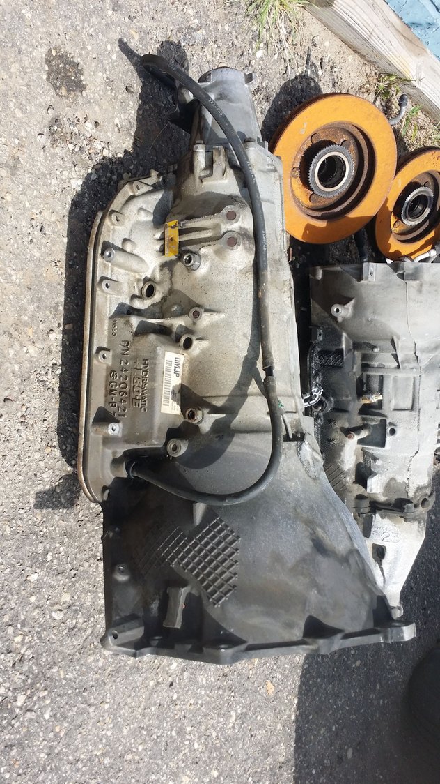

Just getting this going - using all the good pointers on the site. Costs so far:
2000 4l80e - $350
Circle D Triple Disc 3500 Stall - $1,140
Jake's Stage III rebuild kit - $1,090
32 spline 1330 yoke to mate up to my Denny's DS - $73
More to follow...

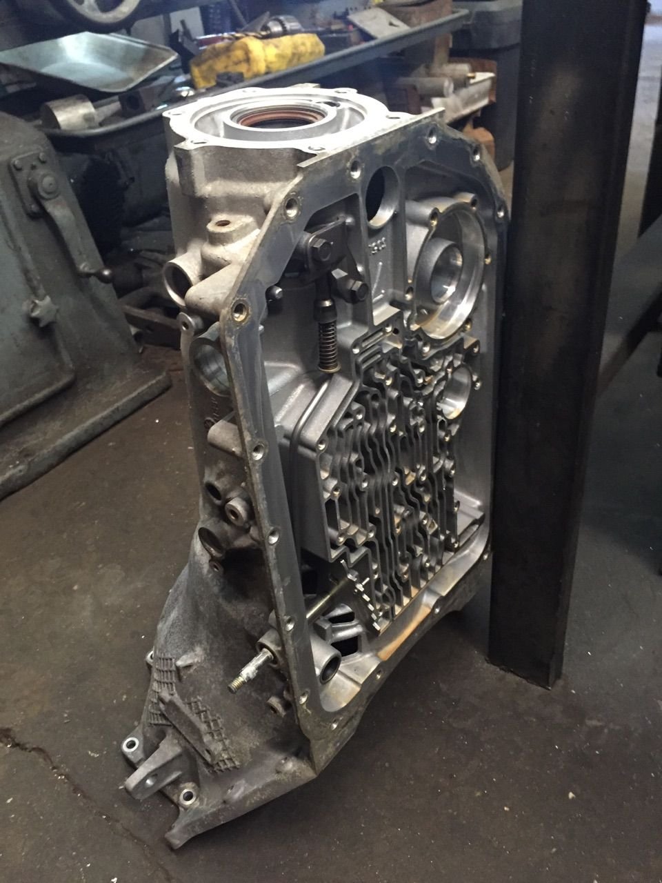

So...since this wasn't a "need it now build", it's been a few weeks but the donor unit is torn down - Jake's Stage III kit going in today/tomorrow - TCI flexplate on the way, PCM back from the tuner (figured I might as well swap out the stocker while the swap it happening - should be going in next week. Will update as needed.

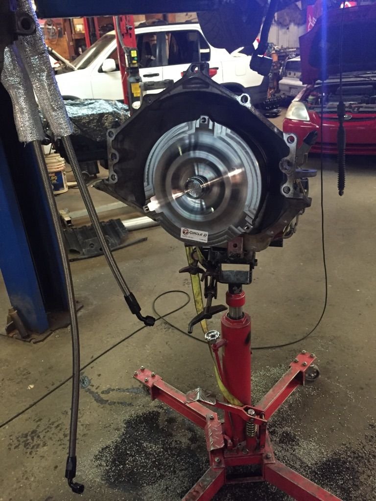

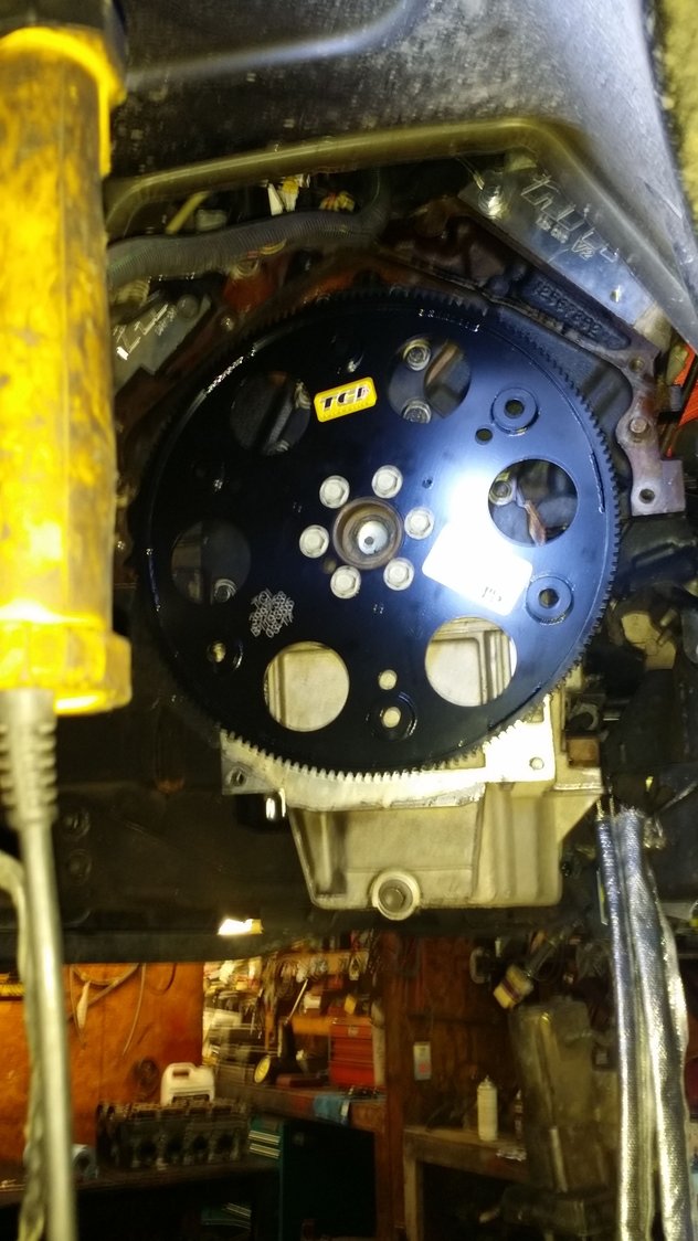

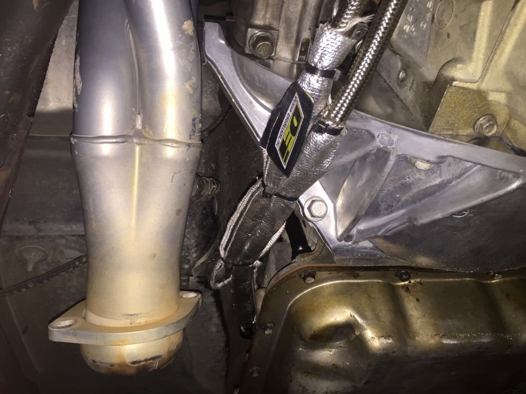

Old Nov 9, 2016 | 06:02 PM
darkirish63's Avatar
Joined: Jun 2011
Posts: 640
Likes: 46
From: NC
Just some pics of how everything went together. Like butta...(no, the spacer on the converter wasn't used)
