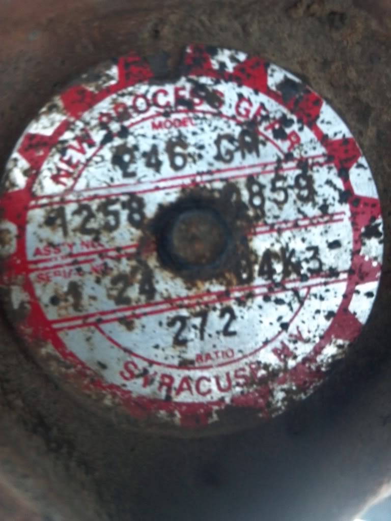

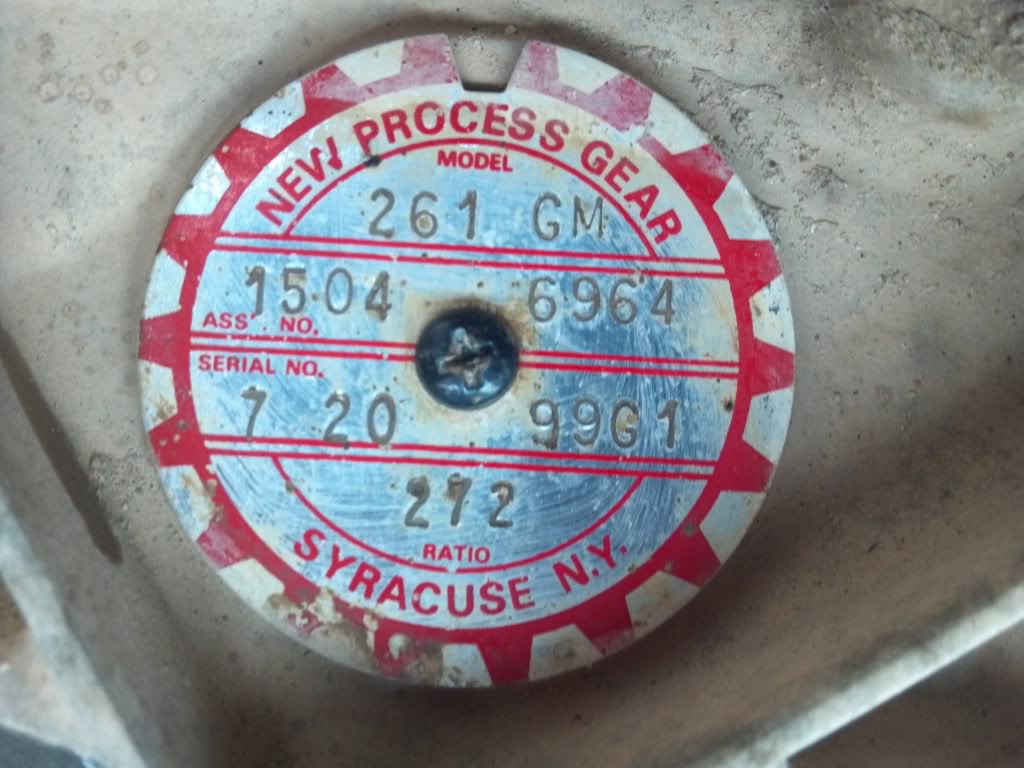

also had a quick question, the t-case came with the tranny. belive its a 2000 as well. i got a buddy that has a 05 front and rear drive shaft do you all think it will work in my truck? the truck was a single cab 2500 hd with a 6.0 and a 4l80e. i know the rear may not line up but would the front maybe work? my trucks a 04 ext cab..
Old Jan 27, 2013 | 01:30 PM
AKlowriderZ71's Avatar
11 Second Hall Moniter
Joined: May 2008
Posts: 11,651
Likes: 10
From: Wyoming
What model # is your old t-case, and your new one?
Old Jan 27, 2013 | 01:45 PM
darnie's Avatar
Joined: Sep 2010
Posts: 1,282
mine says....
the new one that came with the tranny says...
and the one my buddie has is this one...

i dont know jack about this stuff im learning as i go thanks for the help AK
i just took my current drive shaft, and it went into the transfercase that the dude sent with the tranny. im thinking it could be the same kind of transfer case but with the new shaft already installed into it?
