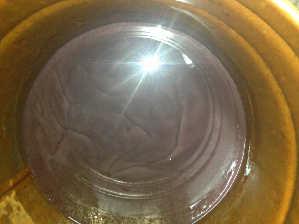

I pulled the pan and the filter and found... metal mania. Looks to me like some of that swirling goo from one of the ghostbusters movies.
Picture below if you can even see anything of it.
Not sure how much oil this pan is supposed to hold but it looks to me like there is not enough fluid even though the dipstick showed right in the middle of the HOT area.
Also, the filter looks ok, I am going to go ahead and replace it.
I wonder if its possible all this metal fouls up the filter then floats back down when I shut it off.
Then where is all of the metal coming from? I don't have much transmission experience but I assume this is not normal.
If I assume the trans temp gauge in the dash is ok its never gotten above 200 and normal driving is around 150. Pulling boat trailer usually 160-170.
Thanks suburbazine for your input!!
Any ideas for where to go from here? Anyone?

Old Sep 23, 2013 | 09:18 PM
aldrichg9's Avatar
Joined: Aug 2012
Posts: 61
From: Terre Haute
Forgot to mention - I am not going to pretend I have ever seen clutch mud but it appears the only thing in the bottom of my pan is more metal....
Old Sep 23, 2013 | 09:20 PM
Ferocity02's Avatar
iTrader: (59)
Joined: Apr 2003
Posts: 9,447
Post some pics of said metal. Regardless, I think it might be time for a rebuild.

Old Sep 23, 2013 | 09:32 PM
aldrichg9's Avatar
Joined: Aug 2012
Posts: 61
From: Terre Haute
So where does all this come from in a supposed 20k mile transmission (I have no reason to doubt the PO)
I dont want to simply rebuild blindly just because I am having trouble.
And how do I know iif I need a complete rebuild?
I guess I am just looking for where to head from here.

Old Sep 24, 2013 | 10:04 AM
Ferocity02's Avatar
iTrader: (59)
Joined: Apr 2003
Posts: 9,447
Judging by the picture of the filter in the pan, looks like there is a nice layer of "sludge" at the bottom that appears metallic in nature. Hard to tell what is is exactly, clutch material? Bushing? Either way it looks like you may be needing a rebuild.
