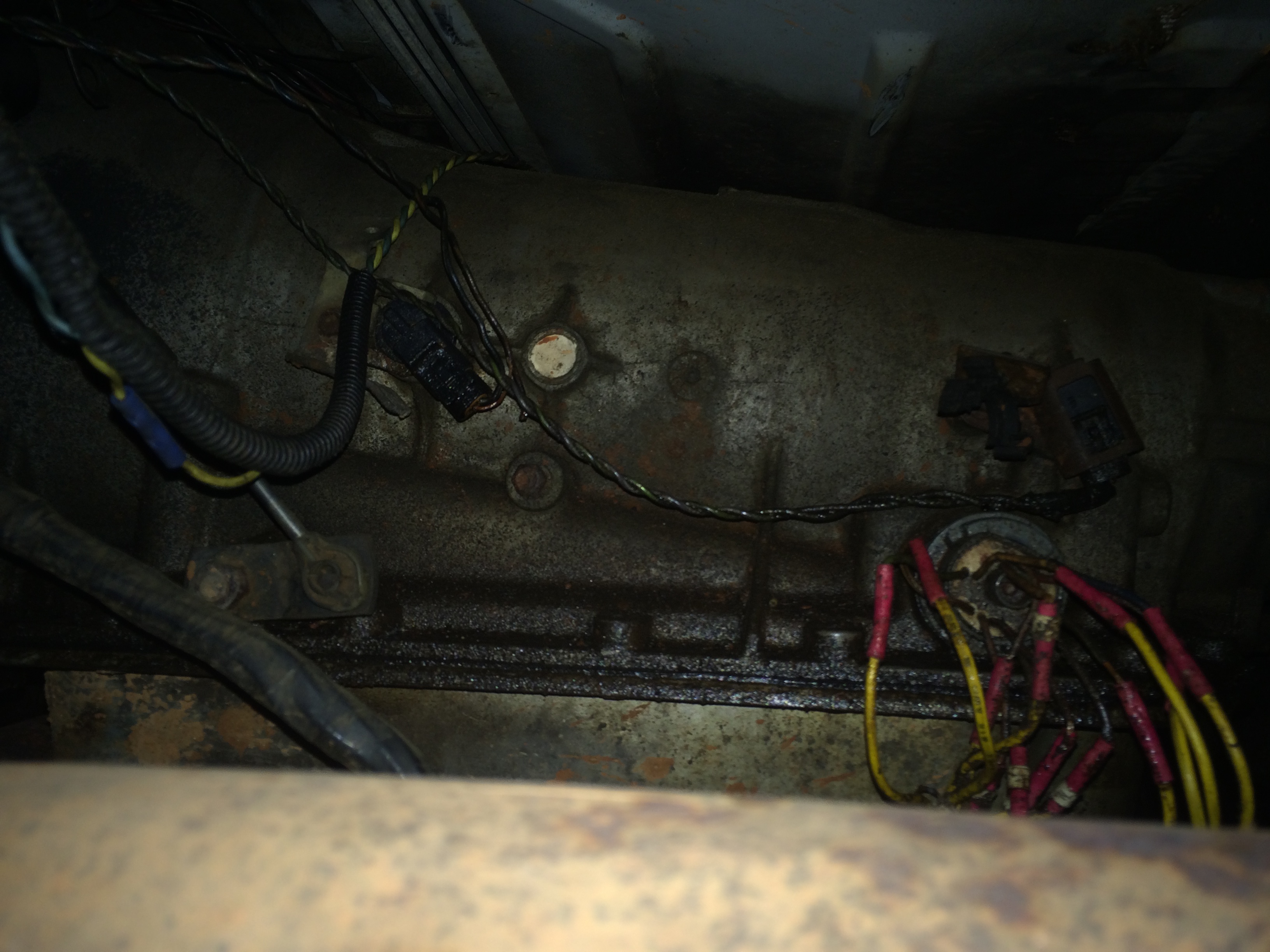

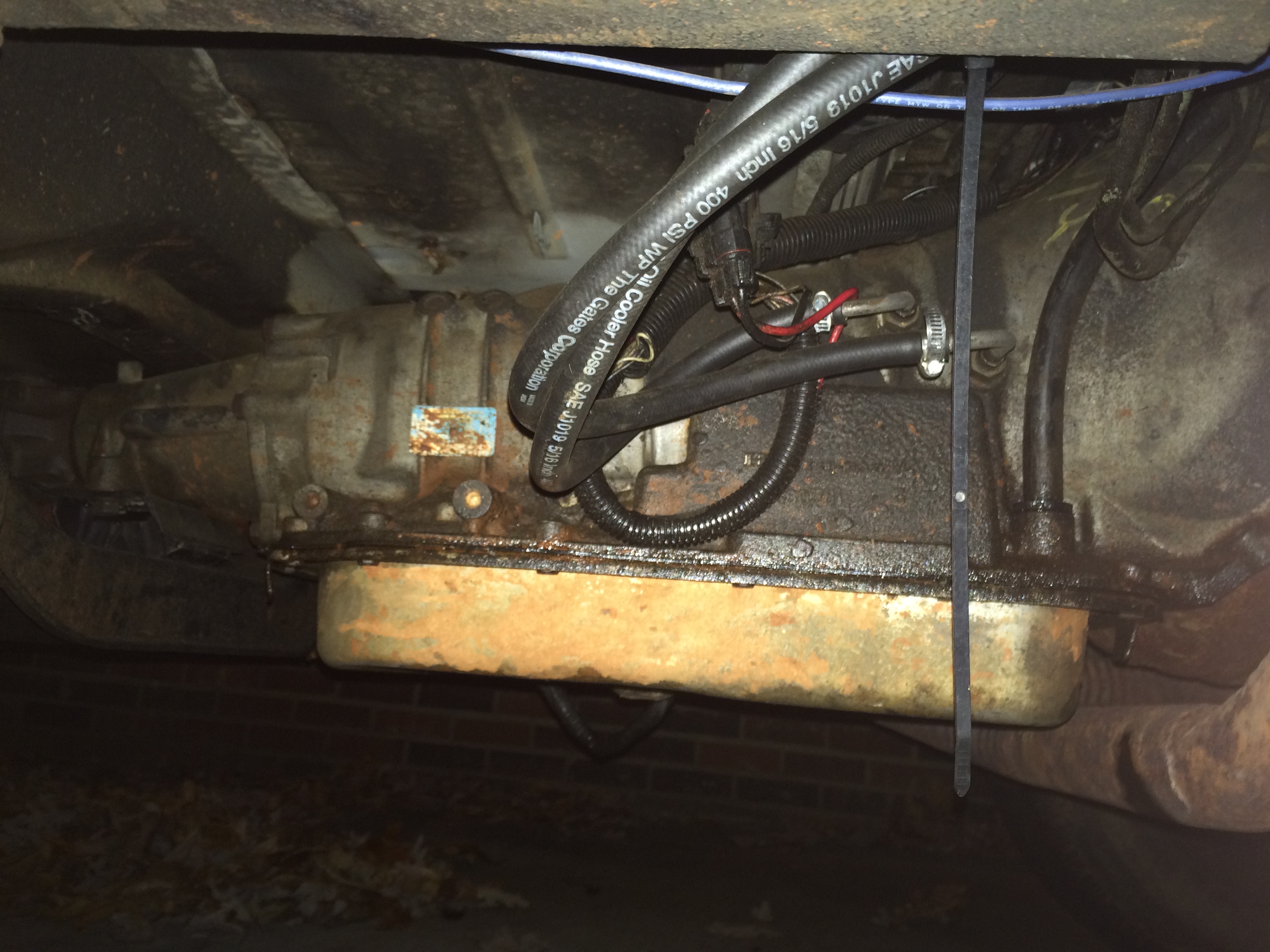

Have a 93 Chevy G30, been using it for a bit. Bought it cheap. I am about to go pick up a new enclosed trailer. I attatched 2 pictures of the trans, best i could get tonight.
At some point it had a rewiring done on it, as you can see its not stock lol.
Truck runs great, shifts great.
Anything i need to know to about to help it last longer? Truck/trailer combo is pretty heavy.
I plan on changing the filter and fluid this weekend. Anything special needed?
Thought about getting a larger pan, and a temp gauge.
On the right side, can anyone tell me which cooler line is the in/out? Sorry so many questions!

The top line is the outlet to the cooler, the lower one is the return inlet from the cooler. Later models have the return line in the rear and omit the internal oil tube that supplies the tailshaft.
You see a lot of discussion here about "not towing in Overdrive with a 4L60-E" but there is no such concern with the 4L80-E. The 80 has a massive dedicated planetary gearset for overdrive. It is intended to hold up under full engine input torque for continuous duty.
Keep it cool and you won't have any problems towing with it. Honestly, they don't run hot unless you have high-stall speed converter in it. The stock spec converter for a 4L80-E keeps the stall speed low and prevents overheating with load.
As for the rewiring... not sure someone did you a favor there. At least get some loom around it.
