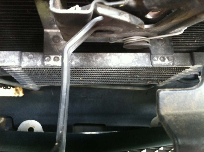

I guess I have a stock tranny cooler. I thought this was an oil cooler, but it looks like the lines go back to the tranmy. Here is a pic of it:
I haven't seen too many tranny coolers on 2WD 5.3's. Is it maybe because it has a towing package? Is this cooler as good as say a standard B&M?
