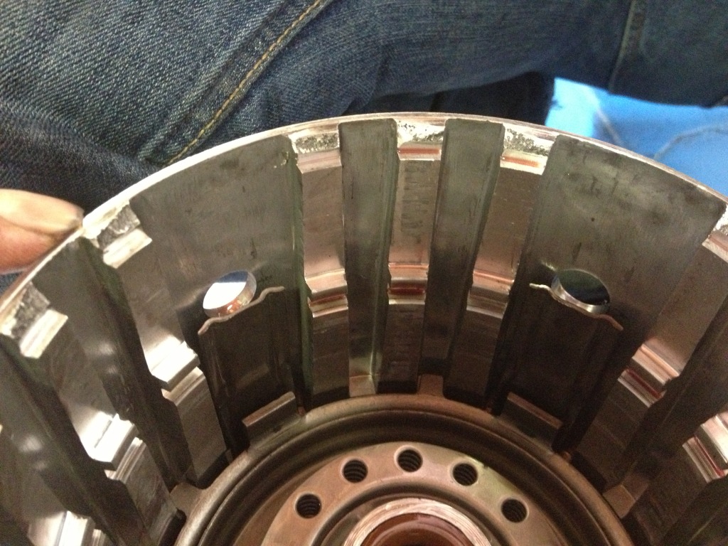

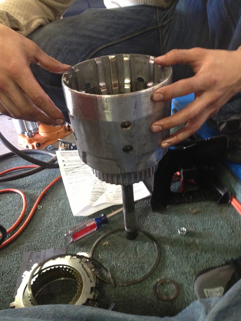

Put a 4l80e in. It will handle the abuse. I broke the teeth off that holds the c clamp in on the input drum. Lost 3 and 4th gears.
