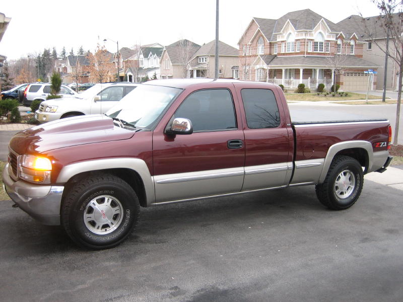

Originally Posted by Faze2183
whats the part number for 4.10s for the 8.5'' 10 bolt???
the GM OEM front gear and pinion P/N is 26060032
the GM OEM rear gear and pinion P/N is 26058945
Both are made by American Axle.
This mod is a must if you have done a 4l80E swap and have big 33in tires. The 3.73s have a difficult time geting out of the hole.
