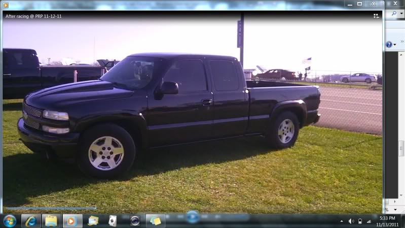

Not sure what im going to do, my truck rides awesome right now , but i still want to go a tick lower.
As she sits now.
Stock keys decranked all the way, belltech 2'' drop shackles/block removed.

..Ur truck looks great dude honestly I wouldn't touch a thing..if u realty wana go a bit lower I'd just get the 2500 keys and get the hangers cheapest and easy. U can put the 2500 keys on and just crank them down a little an still have a decent ride. The hangers have 2 adjustments on them for 1 or 2 inches. But are a pain to install.. ur call great truck all around
