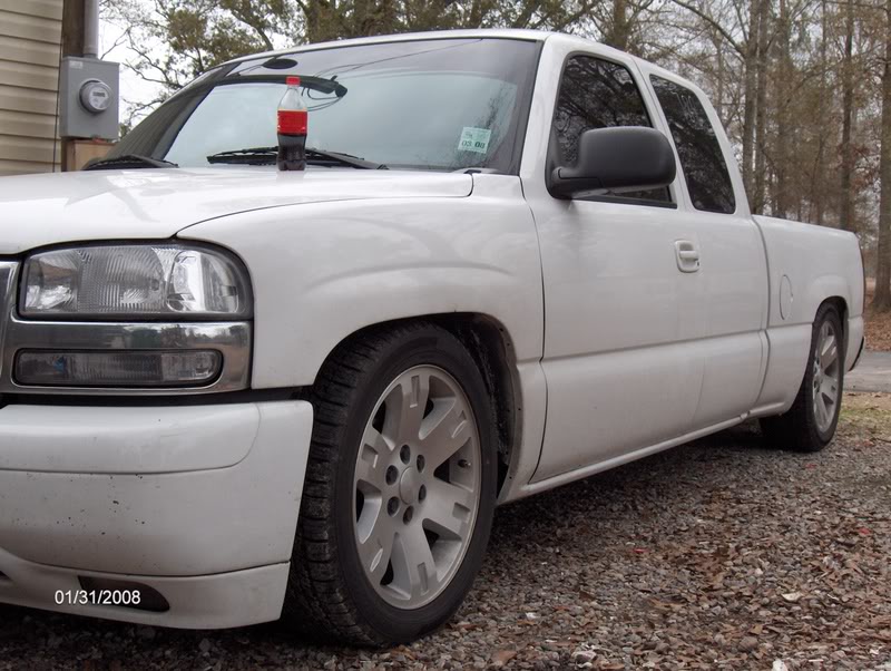

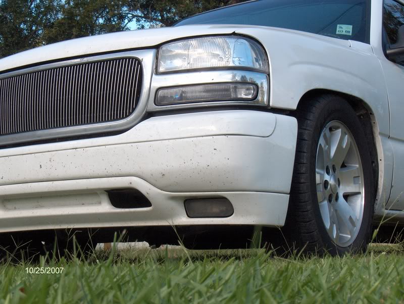

Probably outter fender and inside wheel wells at full lock
I ran a 275/45 on a 4/6 drop on my 2001. I also ran the 275/55s, but took a lot of cutting the fenders to roll them up. An had to lose both plastic liners
I think this is one of a 275/45 after i cut the fenders
275/55s with a 4/6
275/45 with a 4/6
