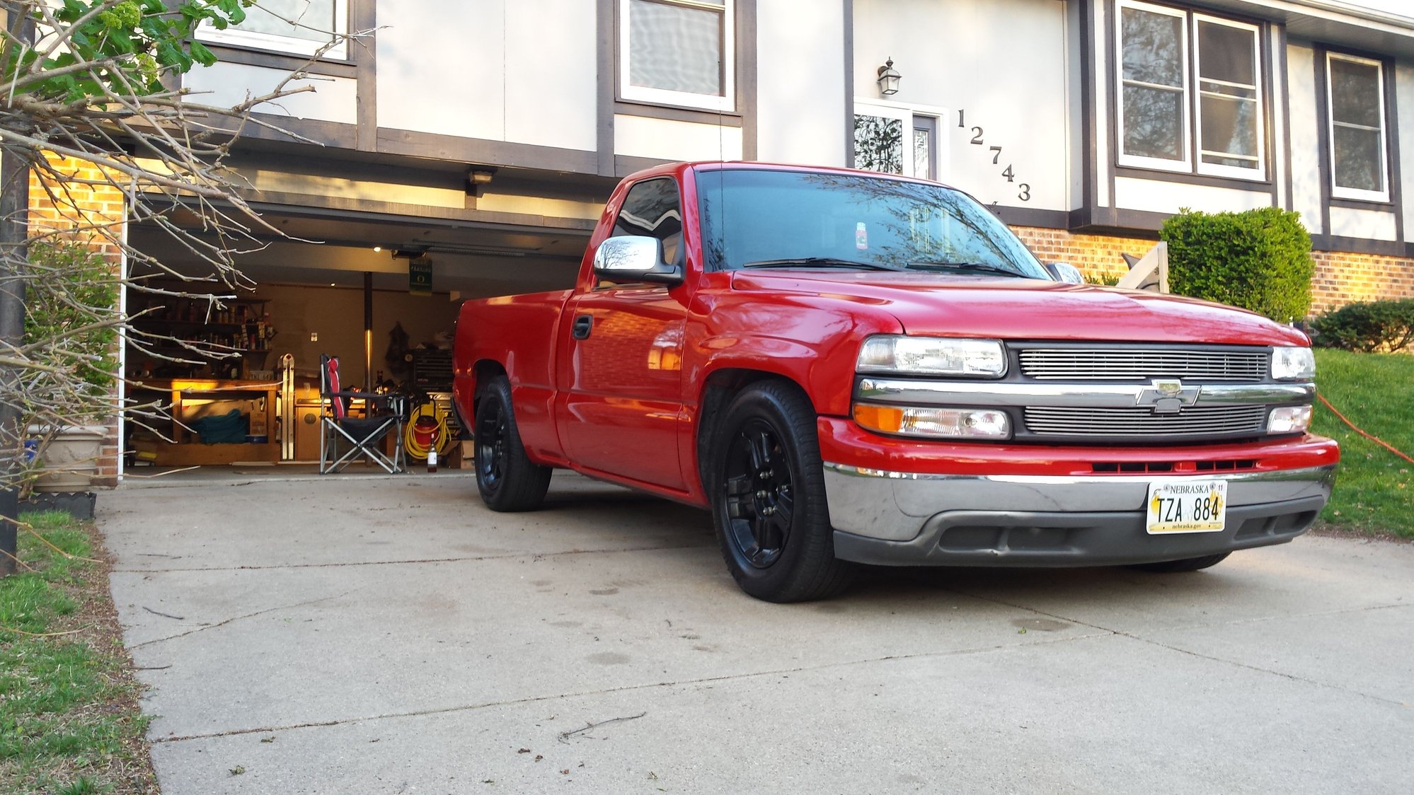

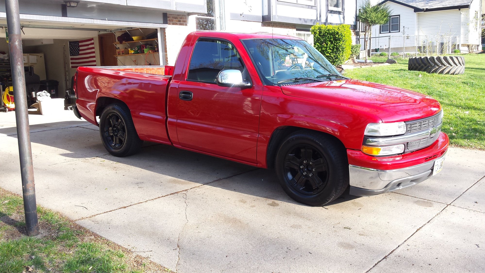

New to the lowering game. Supposedly 2 inch drop spindles and 4 inch rear, 2 inch hangars and 2 inch shackles. Thanks -Kyle.

Forgot to add. Sitting on 18 inch nbs wheels and 29 inch tall tires, 245/60/18

Looking at the rear drop parts would tell you for sure.
If the shackles have 2 different spots for bolt holes and it's on the top hole, that's 2in of drop. If the factory hangers are gone and it has bolted on units with 2 holes, then it's either 1-2in more of a drop.
It looks similar to my 2/4 drop on my sierra but I had 275/55/20's on mine that filled the wheel wells more.

Thank you. I appreciate it. It for sure has 2 inch shackles then. The hangars are bolted in with only one bolt hole. I'm sitting about 4 inches from the frame to axle tubes.

My money is on 2/4. You might be able to steal a PN of the spindle if it's aftermarket to confirm. The spring would be more difficult to ID I'm afraid. Nice looking truck for sure.

Yeah I tried to get a part number on the spindles. Read old forums and seems like they are old belltech spindles. The way the ball joints are. Number on them is gm-99 drop. I figured a 4 inch drop would be a little lower for 29 inch tall tires. But thanks man I appreciate it! Getting harder to find these trucks! For sure.
