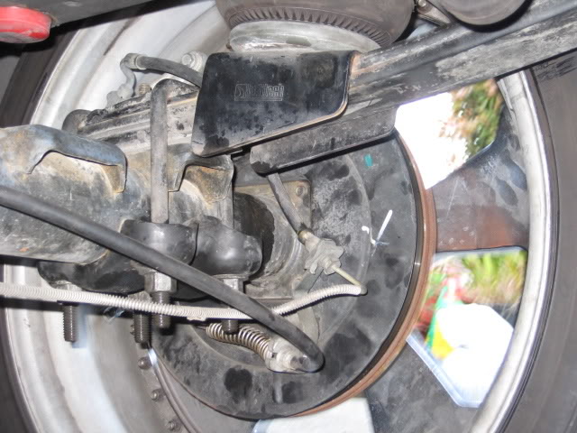

i'm a bit confused the op said the rear disc were a little tilted?... so is it a direct swap to take the drums off and put the disc on or doe's it just kinda work?.. i would'nt want nothing shady?.. also if i wanted to keep the drums off the 05-07 14 rear, would they work on a 04 down disc truck or will they only work on a 05 up?... thanks guys.
The 4 bolt flange on the rear ends are not in the same location. You have to rotate the disk brake assembly a little bit to get the 4 holes to line up on the 14 bolt. In order to maintain the drum brakes on the 14 bolt, I think you would have to get a new proportioning valve. Not sure what else though.
Originally Posted by Atomic
I have an 04 with discs. Would my calibers be a direct fit to a 14bolt from a 05-07 ss?
Yes the calipers owuld fit the same way mine did. You can see how the brake assembly is at a slight angle in the picture.
