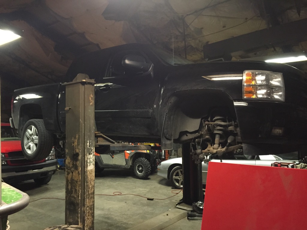

So we finally got the last project off the lift and put mine on and started to tear it apart.
Had to replace ball joints too.
Old Jan 18, 2016 | 10:33 PM
iamkeniff's Avatar
Posts: 5,365
From: Gonzales, la
Lowers are easy, and uppers are a pain only due to it being a full control arm replacement

From: Kansas
How's the progress coming so far
Yea, decided to do struts too. 185k. It needs them. Along with new sway bar end links beings one was busted.
We got the front end torn apart and front diff pulled out so I can replace the leaky oil pan gasket. Got the exhaust off. Had one sticky bolt that broke so all in all that wasn't too bad.
Then I had to head into work. 2nd shift sucks. I am working a double tomorrow so no progress till Wednesday but we'll probably be able to get the 4l60 pulled and 6l80 put back in, possibly along with the transfer case. We'll see. Struts won't be here till Friday so not in a huge hurry yet.
I took Friday off already and am most likely going to take Thursday off, too so we can get it buttoned up. If it was just putting the 6l80 in it would be a breeze. Lol.
Branden
