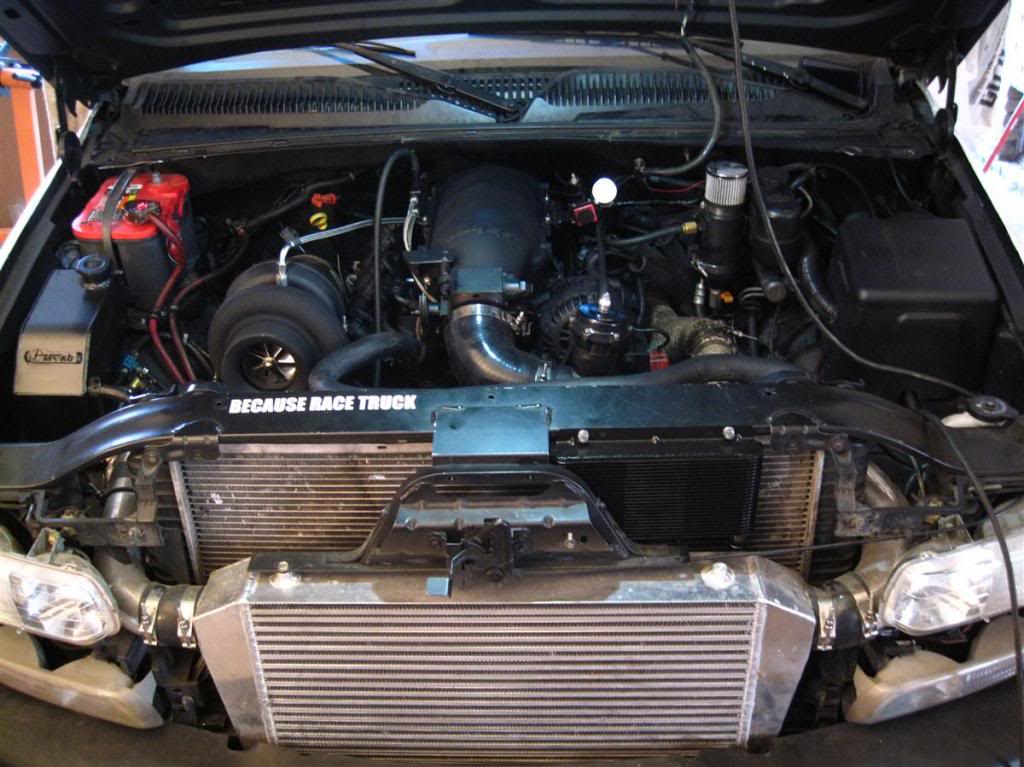

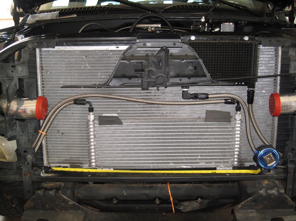

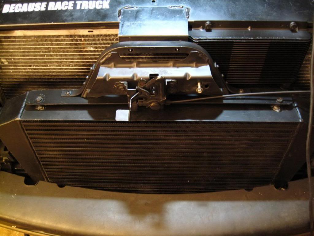

could you guys upload some pics for me? pretty much you have the trans cooler between radiator and condenser and the the intercooler mounted in front?
Old Nov 30, 2016 | 03:51 PM
Atomic's Avatar
I have a gauge for that
Posts: 16,282
Likes: 438
I have done this twice, one on a 99 and one a 2000 both with 4" intercoolers. You just have to jam it in there and cut the A frame thing and use the intercooler as the hood hold down.
Do not put the trans cooler horizontal or in the back, it will not work near as well.
The AC acts as a dehumidifier for the defrost. Yes you will get hot air out even if you dont have AC, but it will not be dehumidified.
could you supply some pictures? im interested and have seen that set up mentioned somewhere. possibly (most likely) by you

This is without the condensor,
