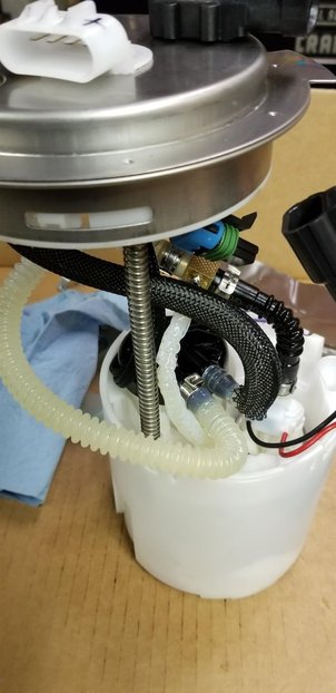

Is that a flex fuel pump? I also bought a stock replacement Delphi pump for a 2013 flex fuel denali. I would save the pump, if it is flex fuel it puts out some good flow. Also, it has the extra small outlet for the venturi, so down the road you may be able to rig up a dual pump kit using that one and any other pump. Then, even if the 2nd one is aftermarket, you have the venturi fill covered!
The assembly p/n I bought was FG1054, but the pump itself had the following numbers:
3380 16119 1
0908
Trying to fit a 450 in it. Yes it is a pain. Got it assembled but am having troubles with leaks at the Tee placed in there to feed the venturi, which is about a 3/16 hose. Cannot find that hose size in PTFE so am trying to reuse the stock hose.
Wish I got pictures of it inside the bucket. Basically I took a piece of stainless sheet steel, put a curve in it to match the radius of the pump's holder. Then I bent it at a 90 to support the bottom of the pump, and attempted to tack weld 2 stainless hose clamps to it; one clamp goes around the plastic housing that holds the pump, and the other goes around the fat end of the pump to keep it from rotating. Had to do some minor trimming here and there on the bucket, also had to be cautious to where the hose clamp screws were positioned so it would all fit back into the bucket. I used Walbro's pump sock, which you also have to pay attention to the orientation of the pump.
Ordering a Tee with more aggressive barbs hoping that will help it to seal. Started out with screw drive injection clamps, they leaked. Installed crimp clamps, leaked but not as bad. I am bench testing in a bucket, luckily, before pulling the tank to install. Doesn't seem to leak until I approach around 60 psi, then it mists at the Tee connections. The goofy looking hose going to the venturi was my attempt to put on some ptfe shrink tube over the hose to protect from chafing if it moved around on me. It didn't shrink down so well...
Finished assembly with Walbro 450
Stock Delphi pump assembly with bucket removed. Still has stock pump. Markups show what was done to hold Walbro (no pics, sorry!)

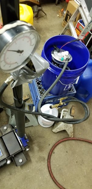

I put a new Tee on this thing, along with new hoses as the other ones had imprints from the clamps and I was afraid they would not reseal. Ran it in a bucket at 100% duty cycle and slammed the valve open and shut on my test rig, no other leaks. Peaked around 90 psi and just under 20 amps. If there was any restriction in the line (read: building any pressure at all), the bucket stayed full at every setting.
Did some testing with a stopwatch, power supply, dc motor controller (21 khz) and a gallon jug, here is what I got. All tests were done at 15v, as my logs show the FPCM seems to always register 14.5-15v anyways. Hope my calculations are correct.
Duty cycle 38% - 45 psi - 1 gal/17 min (22 lbs/hr or 13 lph)
Duty cycle 59% - 58 psi - 1 gal/80 sec (281 lbs/hr or 170 lph)
Duty cycle 100% - 75 psi - 1 gal/46 sec (489 lbs/hr or 296 lph)
The pump didn't seem to want to run under 35-38% duty cycle with any restriction in the line. This happened when dead-heading it or restricting it to get it up to around 43-45 psi. The pump speed would sound like it jumped up and pressure would drop 10+ lbs for a sec, then recover. Almost like there was air in the system but I don't believe there was, as it would do it even after a fire hose run. I don't know what to think about this, but my stock cal has a Min duty cycle for the pump and it goes as low as 18% at 15v and 300 kpa (43 psi), with an absolute Min DC of 10%. I could set the cal at this higher duty cycle but now am concerned that I may not be able to turn the fuel down enough for idle/decel. 72 lb injectors are already down to the low 1.?? ms at idle at 300 kpa.
Keep in mind this doesn't include the restrictions in the rest of the truck's fuel system, it is only right out of the pump.
