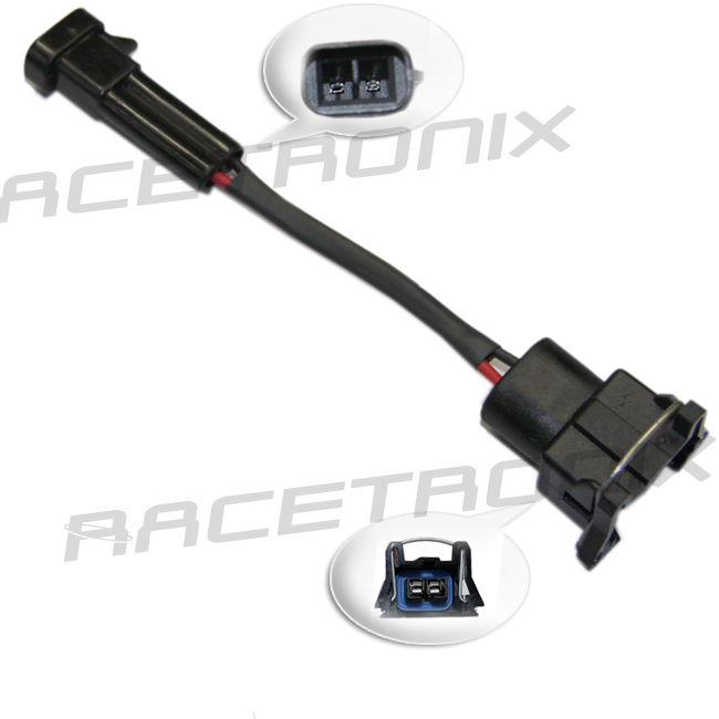

That injector is not a EV1, trucks did not come with a EVI. The part number you provided is a MultecII connector.
What are you goals for it? How hard to you wanna push it? This will determine what injectors you will need and what your options are. Unless it has changed, 43lb is the biggest multecII injector commonly available. Bigger then that and you will have to re wire or get adapters if anyone makes them yet.
Edit- Looks like racetronix makes a wiring adapter for the MultecII's to run a EV1 injector. I have EV1 style injectors but when I did my swap no one make a adapter plug so I just rewired all mine.

http://www.racetronix.biz/mmWEBSTORE/Images/IA-M2M.jpg

Multec II 43lb injectors should work fine for you then, and they are a direct plug and play. Obviously a tune will be required.
