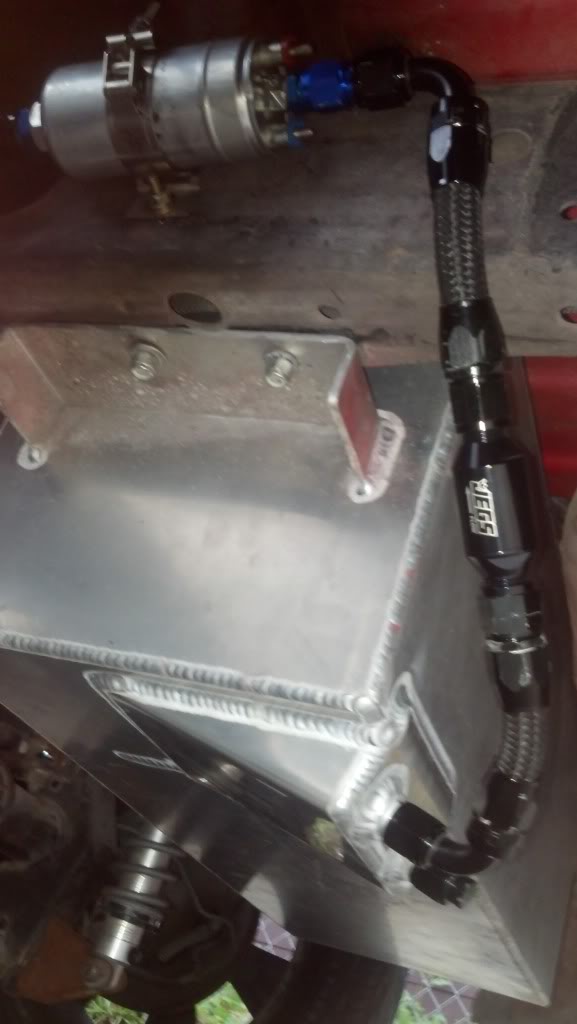

I am going with a 20 gallon cell with a sump. I am planning one running a bosch 044 external pump. They make fuel sending units in the ohm range you need to work with your factory gauge if yours is an 04+
Here is the one i getting, it will take some fabbing to get it to work but that is part of the fun. I plan on ordering it this week.
20 Gallon Custom Fuel Cell

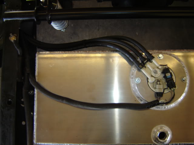

Old Jun 25, 2012 | 11:39 AM
skeet's Avatar
iTrader: (18)
Joined: Feb 2007
Posts: 3,157
From: P.A. TX
Originally Posted by foose04
Jon did mine foose, heres some pics
hes done many, knows the distance from frame rail to frame rail, wont need to send measurements unless you put the cell someone else.
