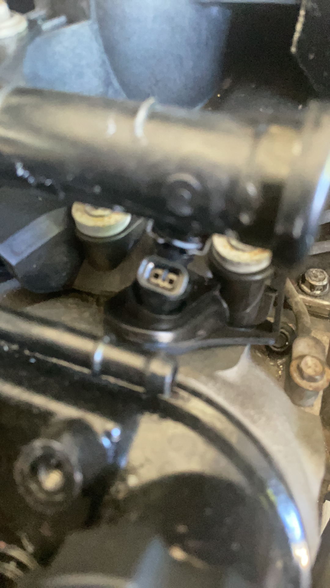

I cannot get these to clip together they look the same style and plug in fine I tried taking out the gasket too no luck any tips tricks?

If that's the right connector, then it should have a little ear on the left or right side of the injector, that the connector latches to. If it has a little ear on the top/bottom of the injector then that is probably the wrong connector. I can't really tell from the injector picture, to blurry. Of course someone will probably chime in here knowing every injector style there is and have definitive answer.

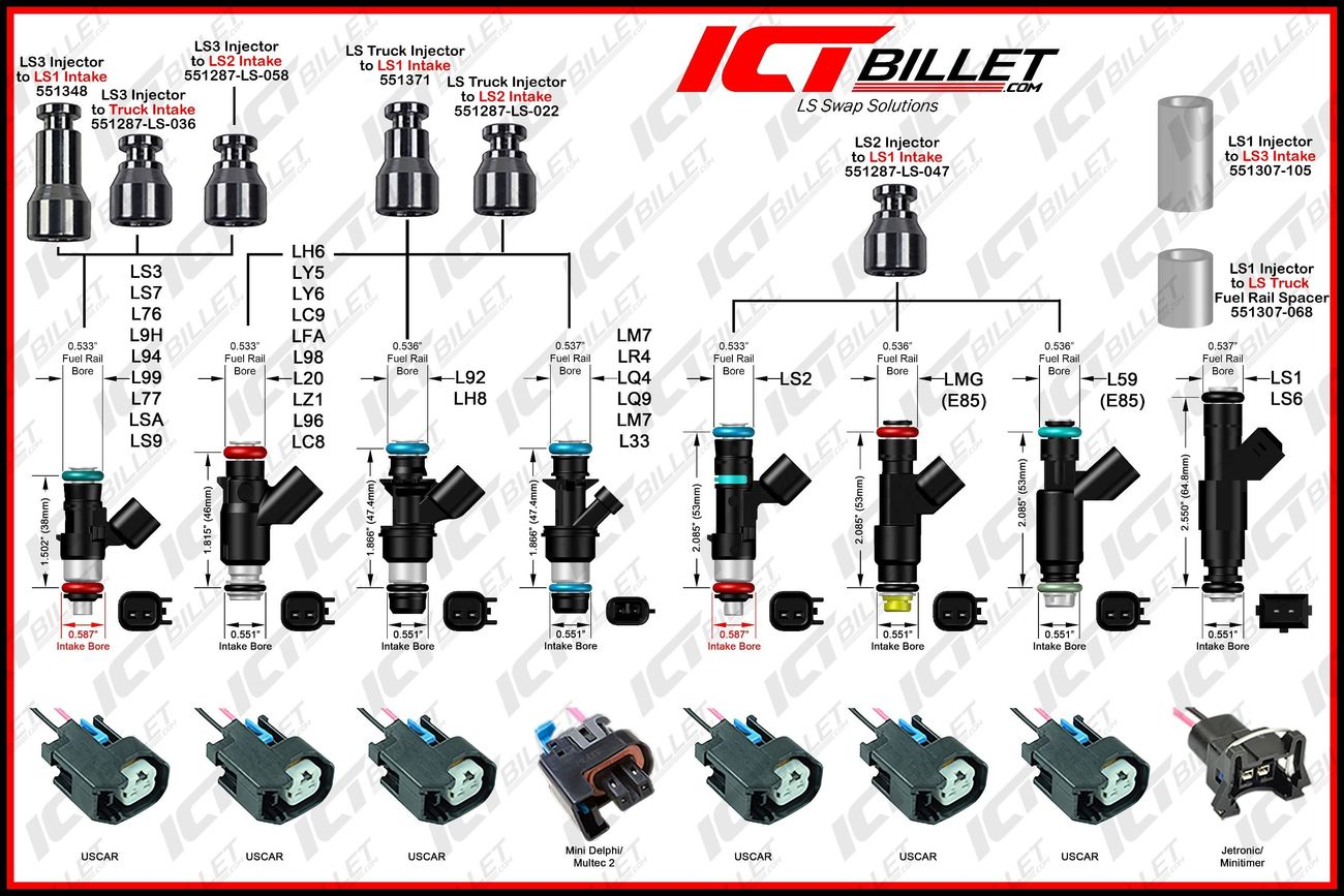

As far as I know there are only three USCAR, Multec and Jetronic
