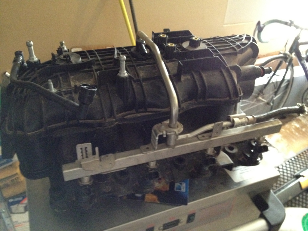

Found this in the corner of a JY warehouse yesterday, got a killer deal on it. I really have no idea what injectors these are, I'll need a metal fuel line, and I need to find a TB regardless. Does anyone know if these injectors are good for E85?

I can't see your sig on mobile but if you have anything done to the truck mawd wise, those injectors won't be enough for e85

just a few bolt ons, LS6 cam, tune. Nothing big.

what injectors are you currently running?

the ones that came stock on the 04 LQ9 I threw in my truck. Came out of an Escalade ESV.

id get 42#ers. is your current set up return style or return less?

its an 04 so it should be returnless. I agree, 42# should be enough.

If its return less, he is good to good. That fuel rail will work with his stock line.

yeah returnless. i'm really not educated on injectors though, I don't know what I have currently or what is on this new style intake either. I was hoping y'all could learn me.

so the intake has 36# injectors, how do I get them to work with my harness?
