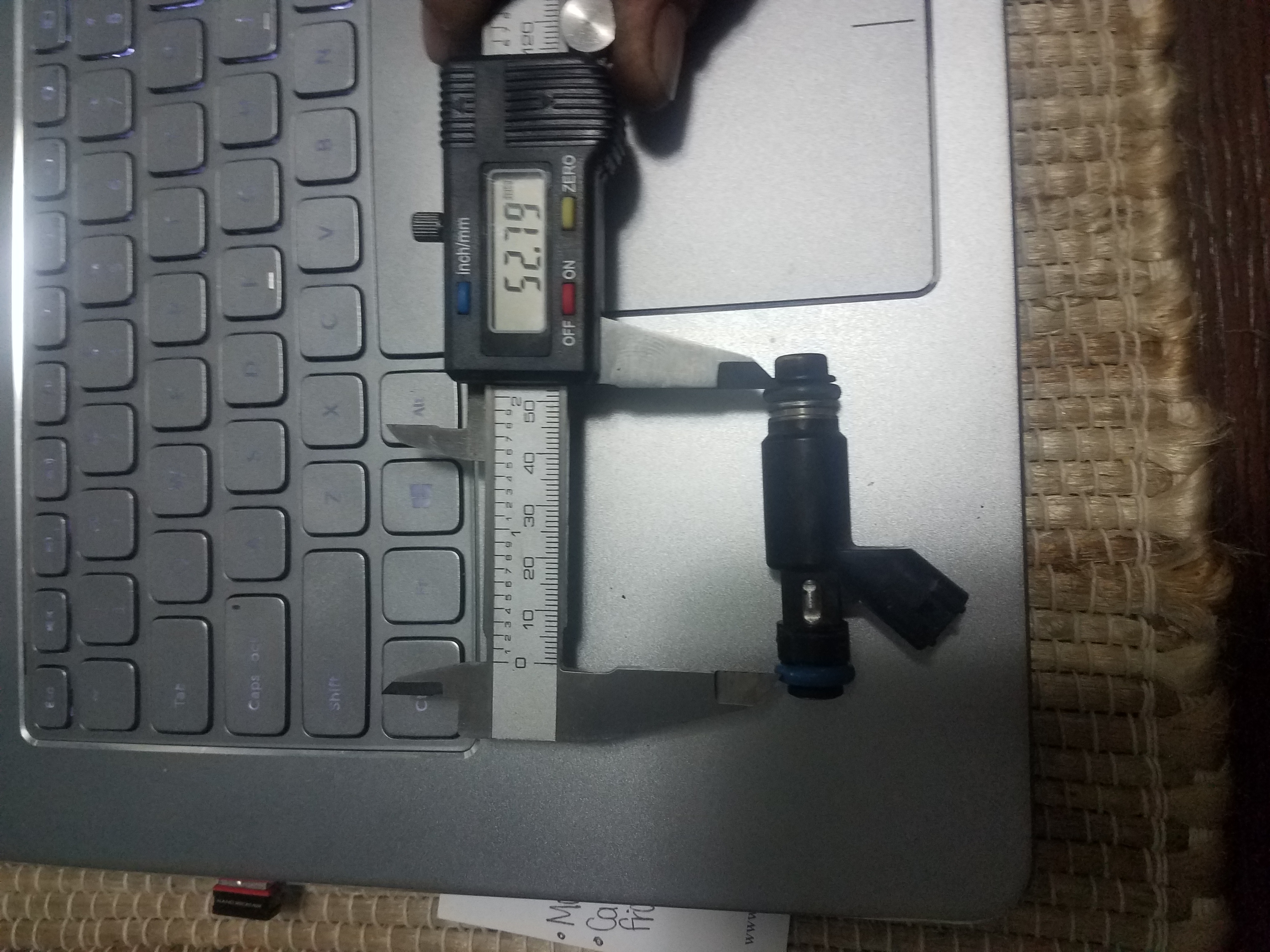

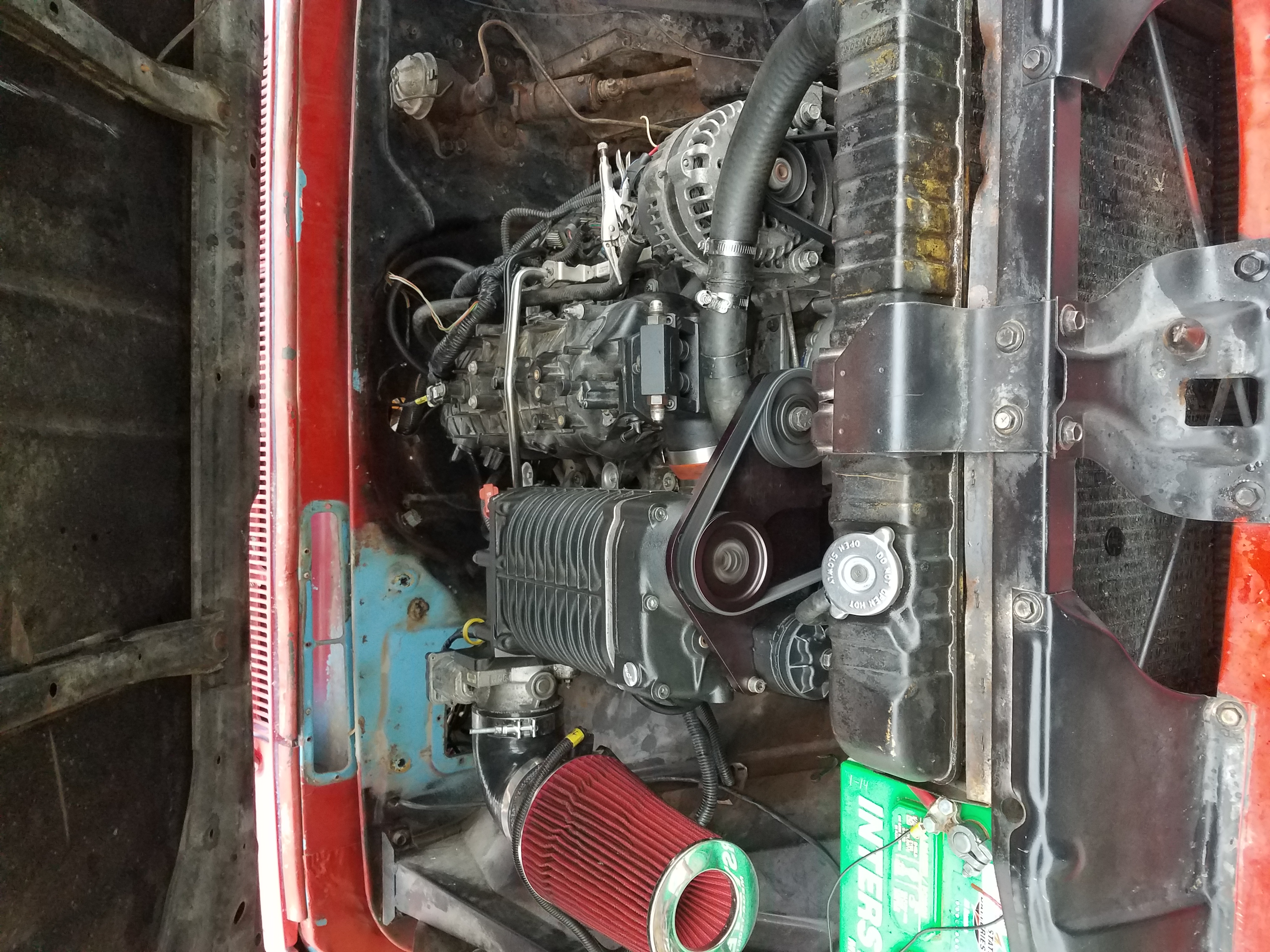

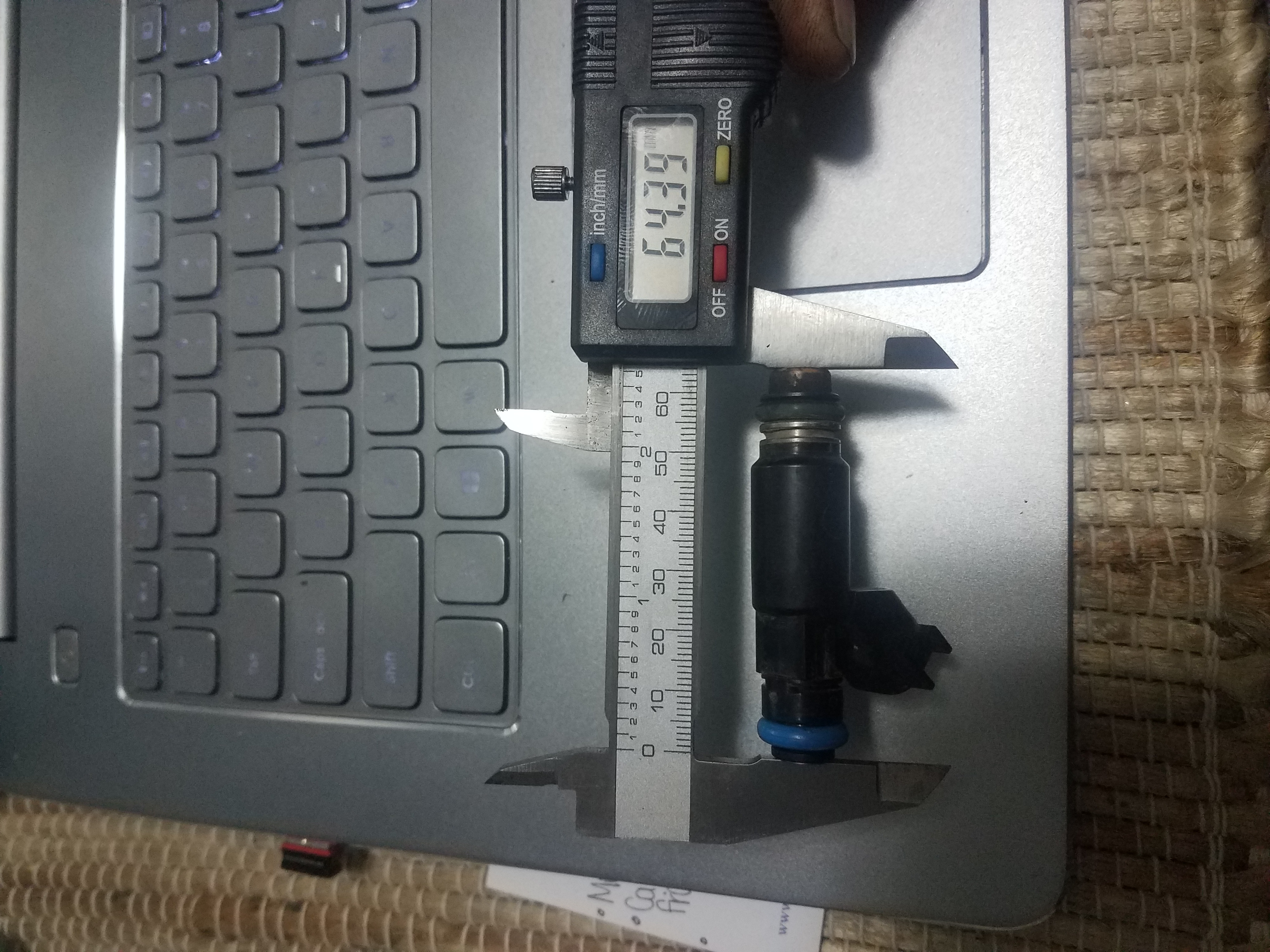

I have a 1964 c10 that I have a side mount whipple on. I need new injectors for my 5.3 truck intake that wont raise the fuel rail up. The truck was a 5.3 z vin flex fuel truck. The current injector number is 12580426.
oring to oring is 52mm or 2 inches
overall length is 64.5ish mm or 2 and a half inches.
I need a 42lb or bigger injector. It has the metal square fuel rail that is returnless also. Does anyone have any ideas.

Pictures of the situation
Attached Thumbnails Need injector help-20171114_131623.jpg   Need injector help-20171116_194833.jpg   Need injector help-20171116_194818.jpg

The problem with those is that they are only 48mm I believe I'm hoping someone can chime in and show me pictures. Or guarantee some fit. I'll give them a call still and ask. Thank you.
