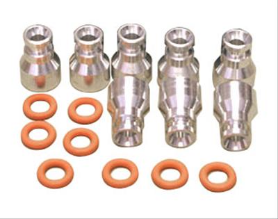

Need an oring part number for using LS3 injectors in the L92 intake. I have the FAST LSXR LS3/LS7 Fuel Injector Spacers 146025-KIT. The FAST oring is the wrong size.
A few washers will space up the rail tab to the right height
Thanks

answer is Fel-Pro ES71190
