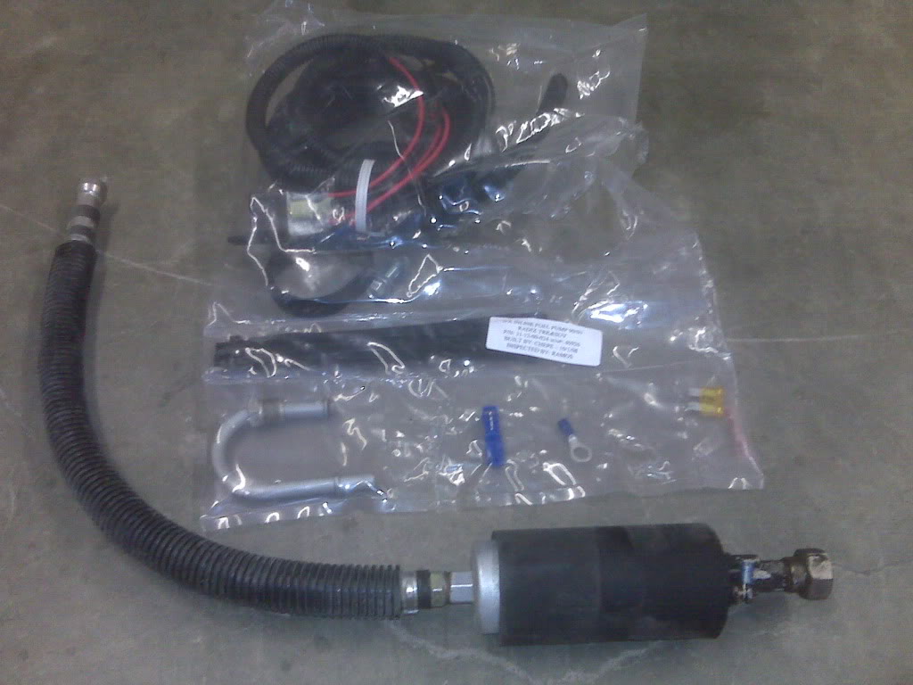

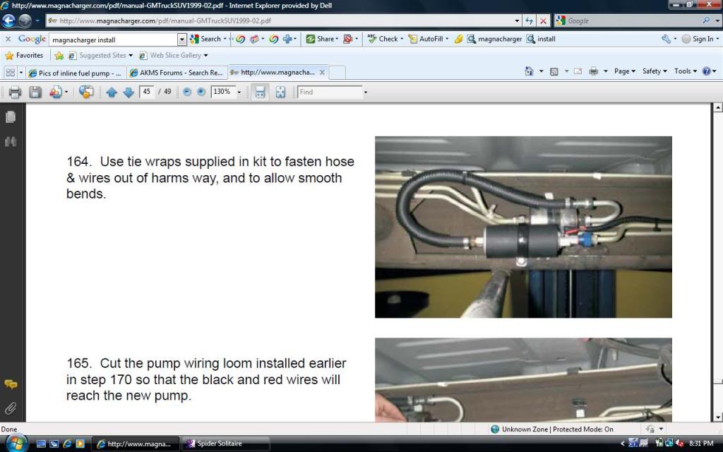

Are you talking about this kit? IIRC, it uses a 190 lph pump, not a 255.
That's not the one I saw but the concept is the same. It would be fairly easy to make this kit myself but I don't know what fittings are required to mate to the factory lines.
So is it possible for one pump to pump fuel through another pump that isn't on (ie when not in boost)? Or do both pumps need to be on all the time?

I wouldn't recommend a setup like this for your goals of a FI 600hp setup.
You need an in-tank setup. Put the second pump on a Hobbs switch. Use a Hotwire kit or build your own if you're good with electrical. It's been done a thousand times on PT, proven to work well.
