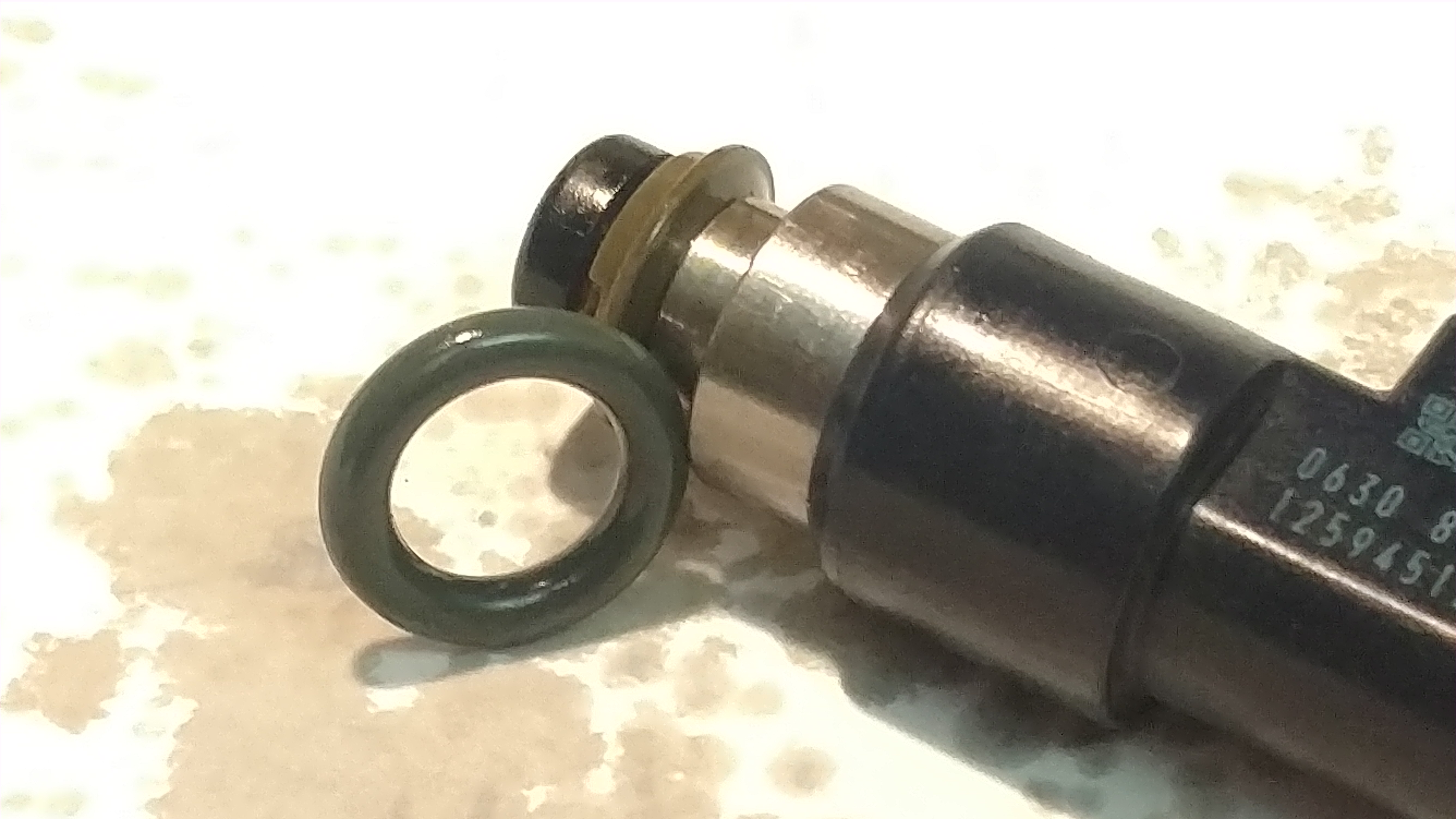

So heres the deal. I am running a tbss intake with holley rails and custom brackets that I have made. I was having a issue with the lower injector o-rings popping out of the injector bore down into the intake and obviously causing a vacuum/ boost leak. So I decided to make some new brackets that had the injectors sitting up higher to prevent this. Well now I had one injector pop out of the rail and spray fuel everywhere, so it appears that the vacuum from the intake is pulling the injectors down some. Has anyone ever experienced this? I went ahead and ordered these new e85 compatible o-rings Bosch Viton O-Rings EV14 Multi Fuel for ID FIC Deatsch 8 Injector Kit | eBay thinking that maybe my old ones are shot and thats whats allowing them to be sucked down.
Also, what really prevents the lower injector o-rings from being pulled out of the injector bore other than friction from the o-rings? Theres not really any lip inside the bore that would stop the lower o-ring from sliding down.

The o-ring is powerfully retained by the flange on the injector. Do your injectors look different than this?

This might be a dumb statement but the O ring goes over that lip/flange area and not below it. Could that be your issue?
O ring installed above raised lip/flange.

No thats not my issue haha. The issue is that when the injector is fully seated and bottomed out in the intake as far as it can go, the edge of the lower o-ring starts to pop out of the bottom of the intake. What I ended up doing (and this is kind of ghetto rigged) was putting a second o-ring above the lower one right where the injector bottoms out. It just takes up slack and prevents the injector from sliding down any further into the intake.
