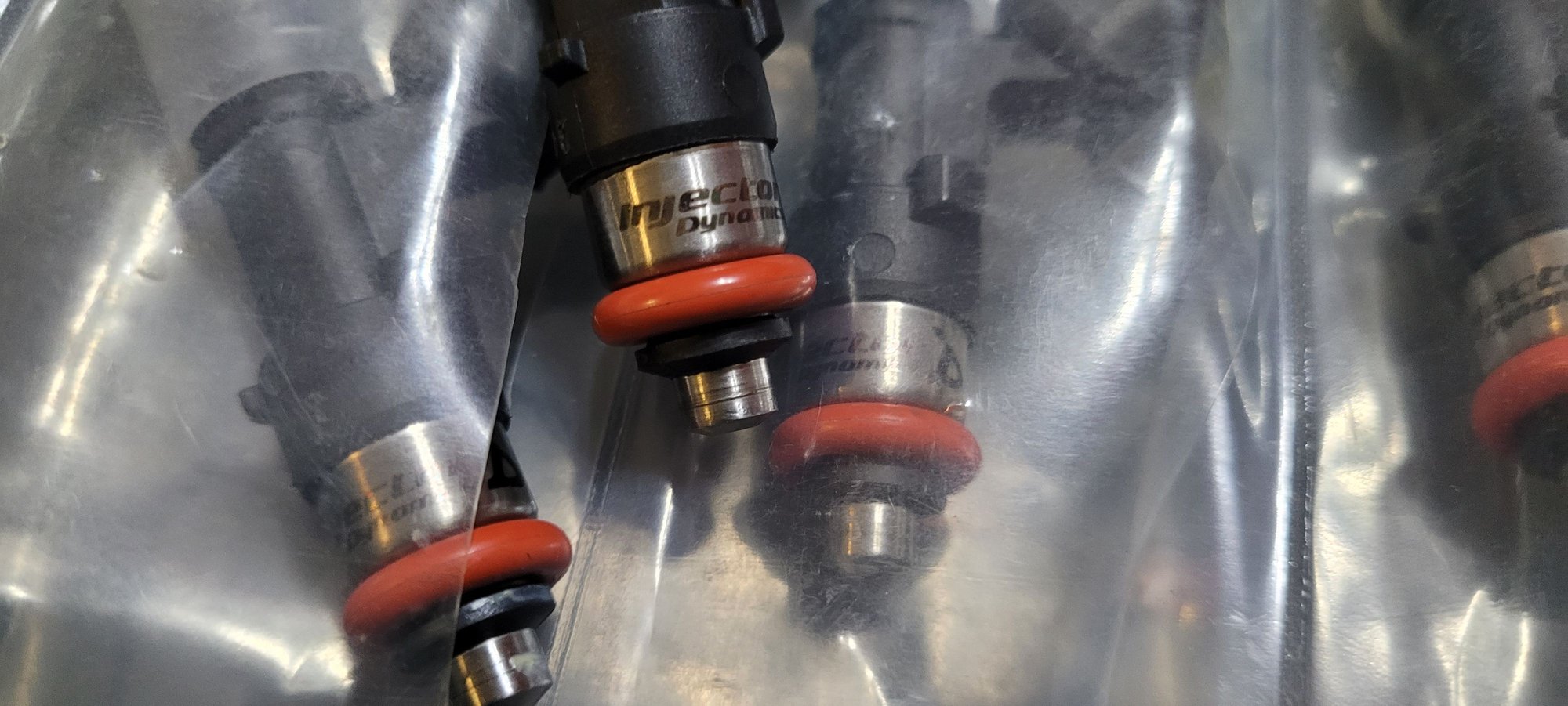

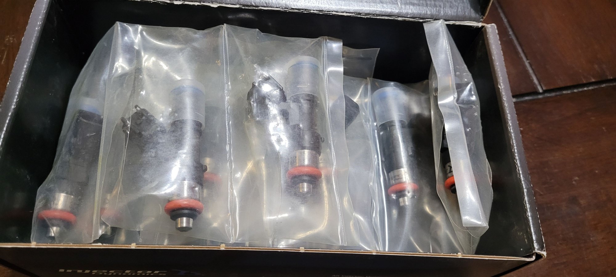

I'll find out soon enough- these came in today. Only 2 Dyno pulls on them. Scoggin Dickey spare parts and got them at almost 1/2 price of new!
