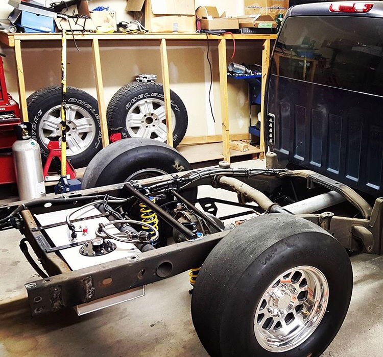

I have a 2007 nnbs Rcsb. It's a ladder bar coil over setup with a RCI-2162a fuel cell. I want my factory fuel gauge to work and I've searched high and low how to do this. Nothing. Does anyone know a way or can steer me in the right direction!?

Atomic, How would I tie into making it work with my factory harness. It's three wires not two. I appreciate your help man

From: Cheyenne, WY

The wires are power, ground, and signal. Should hook right up to your factory wiring.
