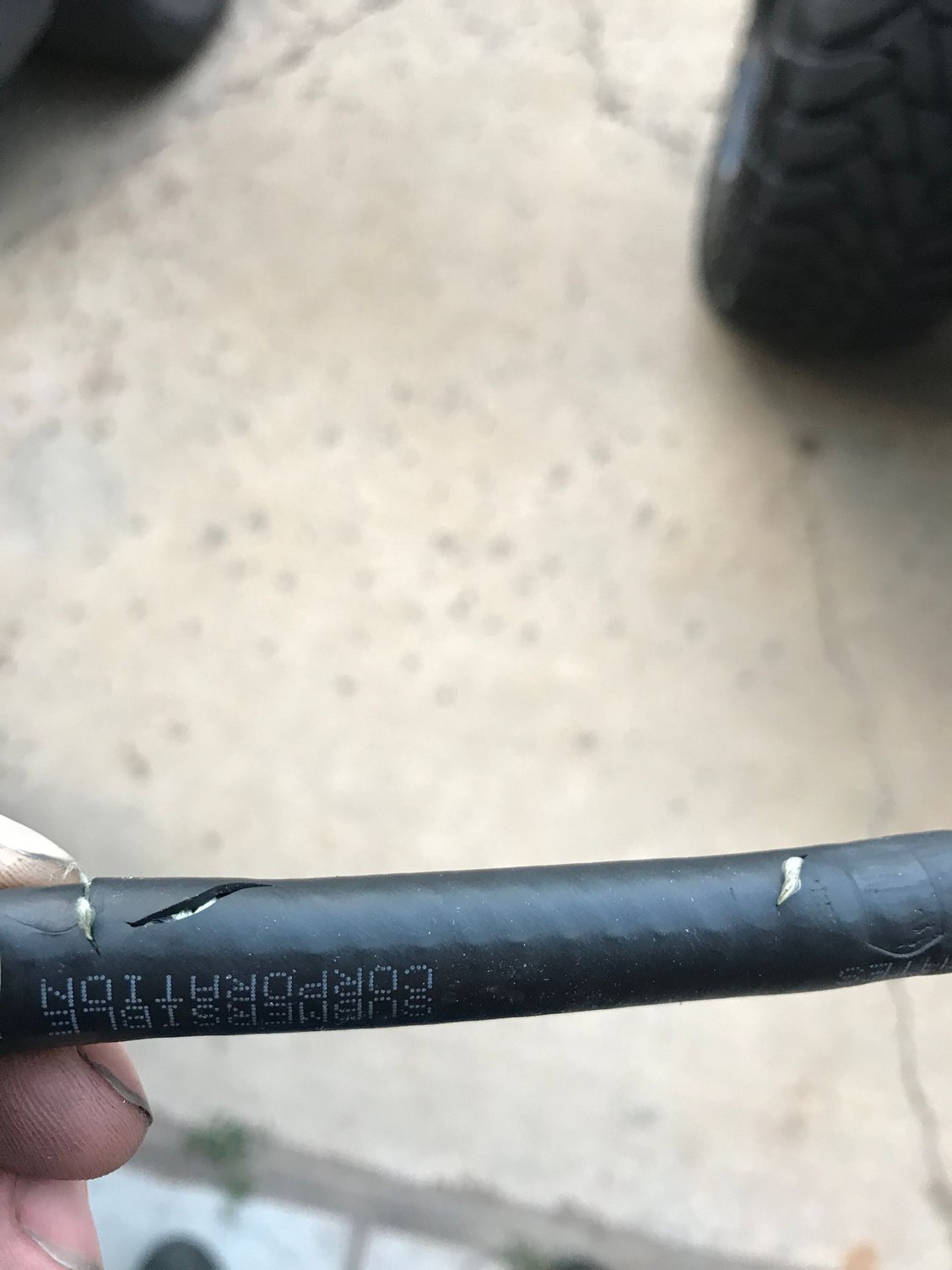

Just to answer the question, I found the problem....

That’s an issue. Who makes the hose?
It says “submersible corporation” on the line.
They may want to rethink their profession choices.

It was Gates submersible hose, part number 27093. Freaking stuff was $31/ft. Kinda pissed it split that fast
