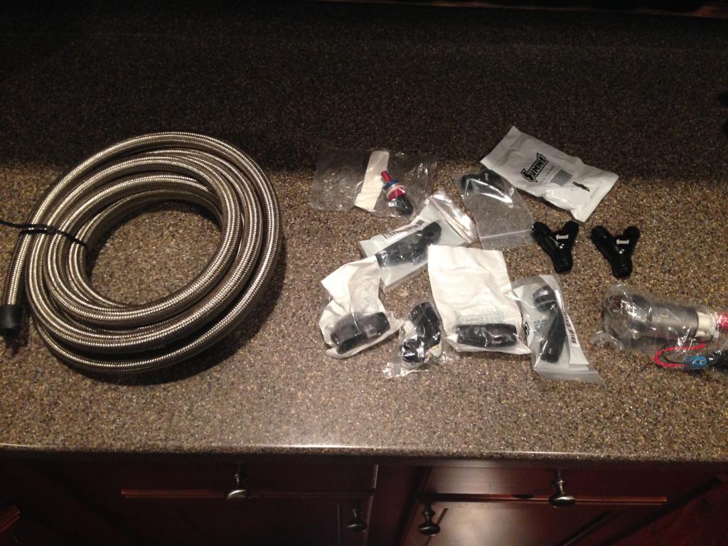

So after talking with a Tech over at Aeromotive, he wanted me to run twin eliminators or a single Pro. Looking into the cost of that setup to include either fuel cell jazz or sump my factory setup, I opt'ed for tossing one more 450 in the loop & keep my factory setup in place. He also didn't like the -8 at this point in my build as a feed line.
Not 100% how i'm going to configure the basket inside the tank, but the basic will be two walbro's Y inside the tank (currently setup), the last walbro will then Y in out of the tank around the hat. The feed line will be a -10, splitting to -8's to feed the rails. My current regulator is limited at a -6 return, so i'm going to try and leave this second 450 walbro on the same Hobb switch the other Walbro is on and have them only on under boost 3-5psi. If i'm dealing with to large of a pressure surge later, I will have to switch to a -8 return style regulator and use my old -8 line as the new return.
Justing waiting on the -10 25 Micron fuel filter to come in. God speed to red!

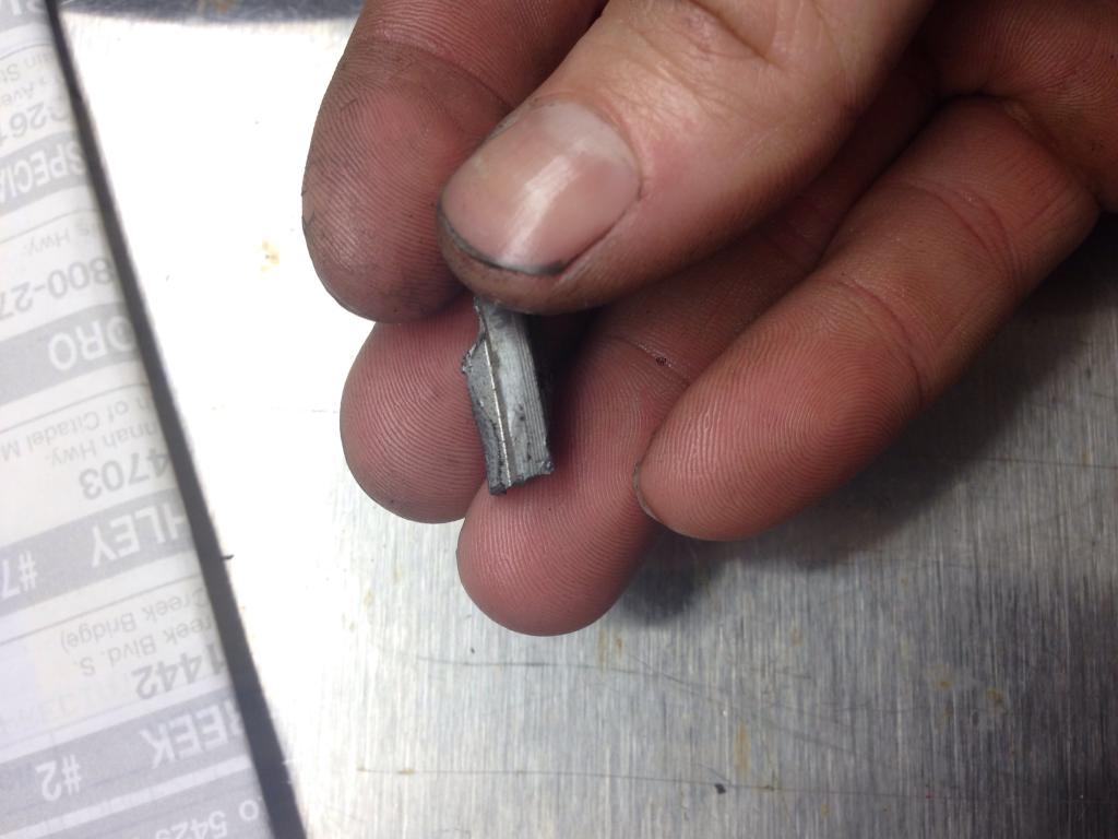

That moment when you drop the tank and find what looks like a piece of the 4.greats piston... The motor finally got to go 9s. Lmao.
