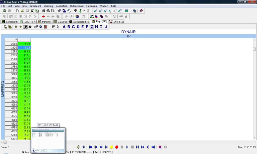

Actually you can build your MAF table while your tuning in SD... Fail the MAF like usual but keep it plugged in, then just make a MAP that looks like your MAF table and log MAFFREQ and GM.DYNAIR. You can pre-populate it...

Yeah...you can do it that way too...either way though, a proper MAF tune includes VE.
I've seen the GM.DYNAIR trick work correctly on some vehicles and not correctly on others...usually it's pretty good AFTER the VE is close to finished. It's certainly close enough that when you re-enable the MAF the error isn't so obnoxious that it won't run, but might still require a little tweaking.
If you get really good at math, you can set it up to actually tune the VE and MAF in one log...long as you get a lot of data.
The problem vehicles are the ones with a lot of air turbulence over the MAF sensor...they wind up in the wrong cells at the wrong time when trying log the dynamic airmass...can be hard to correct them when tuning the MAF with the wideband too.
