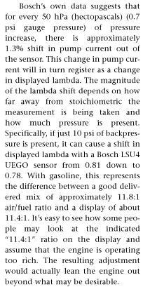

Something else to contemplate for those with FI, from Greg Banish's book.

Also, just to add, I'm sure we can recall those situations with people blowing motors under boost yet "the AFR was perfect." Let me propose that, in fact, the AFR was not perfect. In fact, it was possibly way off. In the above test I posted, the Bosch sensor in the LC1 (very common WB) was 7/10 of a point off reference. Combine that with error from back pressure and the true AFR could be well over 1 point higher than thought.
