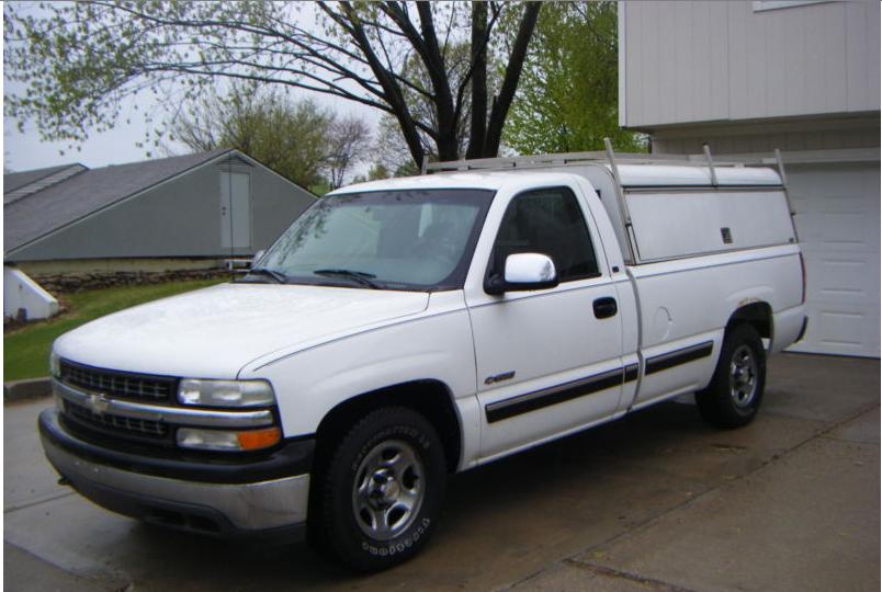

Flying to K.C. Mo. Wednesday to pick it up. Got a great deal on ebay and it sounds like a well cared for truck. Going to start a thread in the projects section too.
