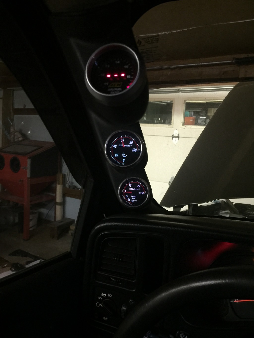

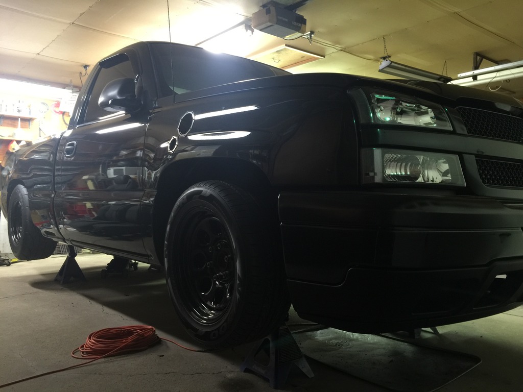

Just a little update guys ended up getting some AutoMeter Nexus Gauges off a member here, and an AEM Wideband figured I'd post up some pics. Also, got the seats out to start fabricating brackets for a set of Corbeau CR1 Seats. She's still sportn her winter lift kit (jack stands) lol, getting ready to pull the 60E within the next couple weeks to get ready for a TH400
