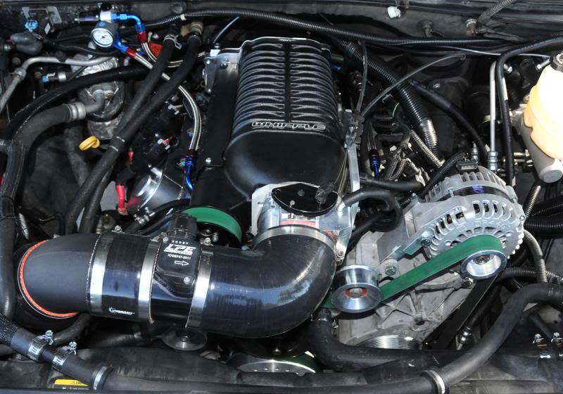

You have to pull the radiator hose to change a belt? That is retarded...
There are different ways to run the Whipple. The picture below looks like the 5th gen camaro power steering and water pump, so pulling the radiator hose is not necessary. However I am using the truck set up, I am going to be running hydroboost and wanted to keep the factory lines. Here is a pic with the truck accessories and modified bracket. This is not mine, but exactly how I did mine.
