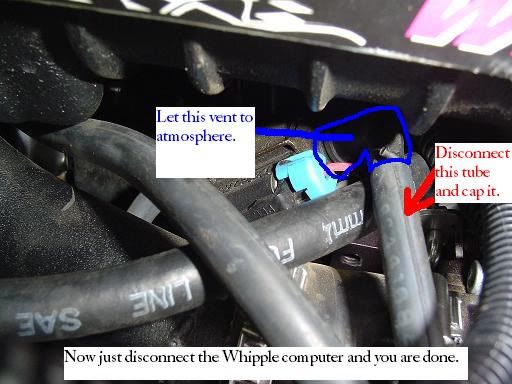

Anyway, Blown 5.3, if you have installed bigger injectors, you must already have retuned, so the only things required to eliminate the Whippletronic's interference is to unplug the Whipple computer from its main power relay, and reroute the bypass solenoid's vacuum lines as shown in this
picture, supplied by I can't remember who on this website.

Thanks for all the info. guys. So just disconnect the vacume line and let the nipple vent and disconnect the piggyback and I'm done. Theres no solenoid to rewire? correct?

thats all you need to disconnect.. Dont forget to Add bigger injectors and a Re-tune first !!... Also give us an update on your Track times !!...
