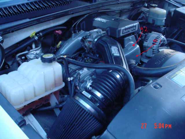

Where would the best place to spray the meth on my application...I've included pics...I was thinking of injecting it right at the elbow on the intake..
any suggestions?
does location #1 look best, or does #2 look better

I agree number 1 looks best. More of a flat surface to tap and it sends it straight in.

Wouldn't the best place to spray the meth be the inlet tube?That would be a lot easier.

In a bend in the charge pipe is what I'm told allows a good flash. Bends are where there is the most turbulence. What I'm about to install isn't the most preferred by some but I like it. I just had a 1" CNC machine throttlebody spacer made and it's off getting a spray bar put in it. I'm having the bar drilled with holes to equal a 600ml jet. This will "fog" the meth in behind the tb which to me will allow a good atomization.

According to the Snow Meth instructions, the best place to spray is in front of the throttle blade somewhere between it and the maf. I drilled and taped my throttle body on the left side about 10 oclock right infront of the throttle blade.

I've been told that the meth isn't good on the rotors/internals of my blower. I thought that meth can corrode the inside of my blower after a while.
Is that true? thats what I'm wanting to spray after the blower....

Thats a new one on me. I have never heard that before. When you spray it, mix it 50/50 with water. It will last longer. That stuff aint cheap.
