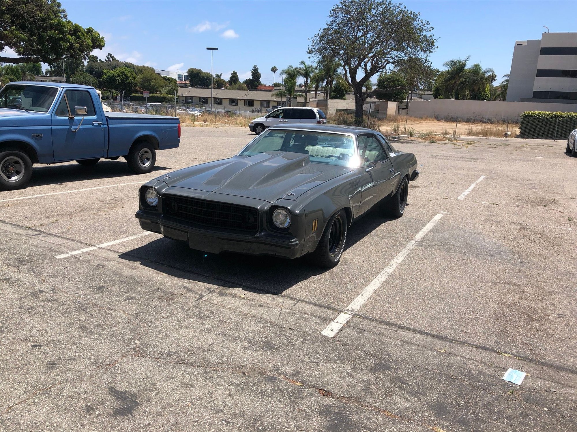

pictures of my truck and Chevelle.

Don't mean to go off topic but that truck is the factory green? Looks a little dark to be it but **** the paint looks amazing.
Old Feb 19, 2022 | 08:23 PM
JF01's Avatar
Joined: Nov 2021
Posts: 37
yes it’s the forest green metallic or whatever the name is. Body has 270k on it. I got it from the org owner for $2500 in March. Took all the trim and emblems off and detailed the crap out of it.
