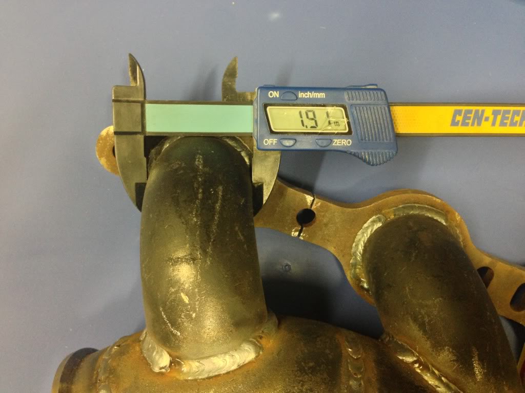

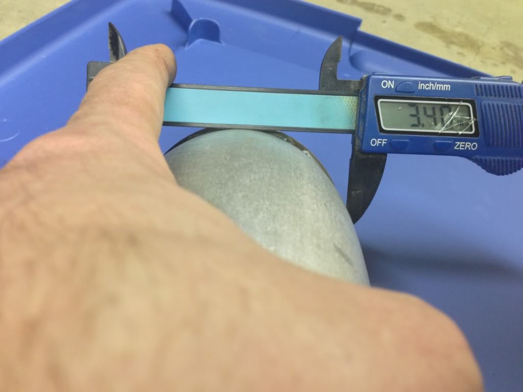

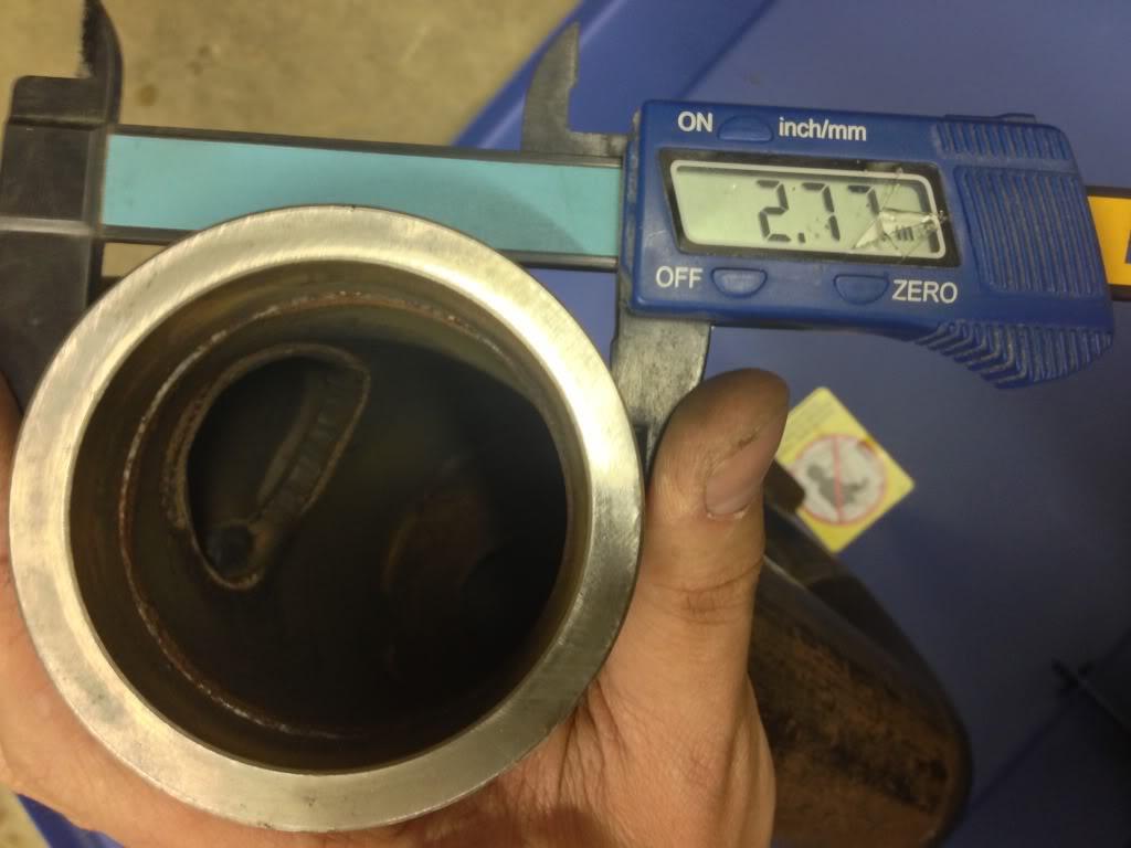

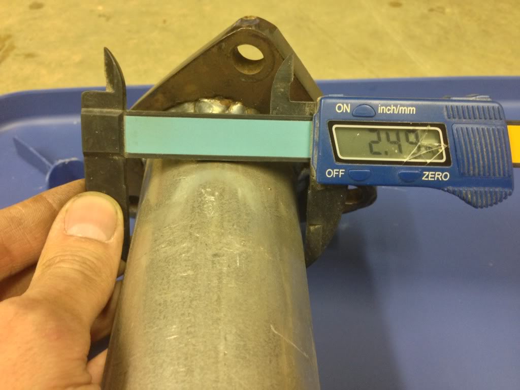

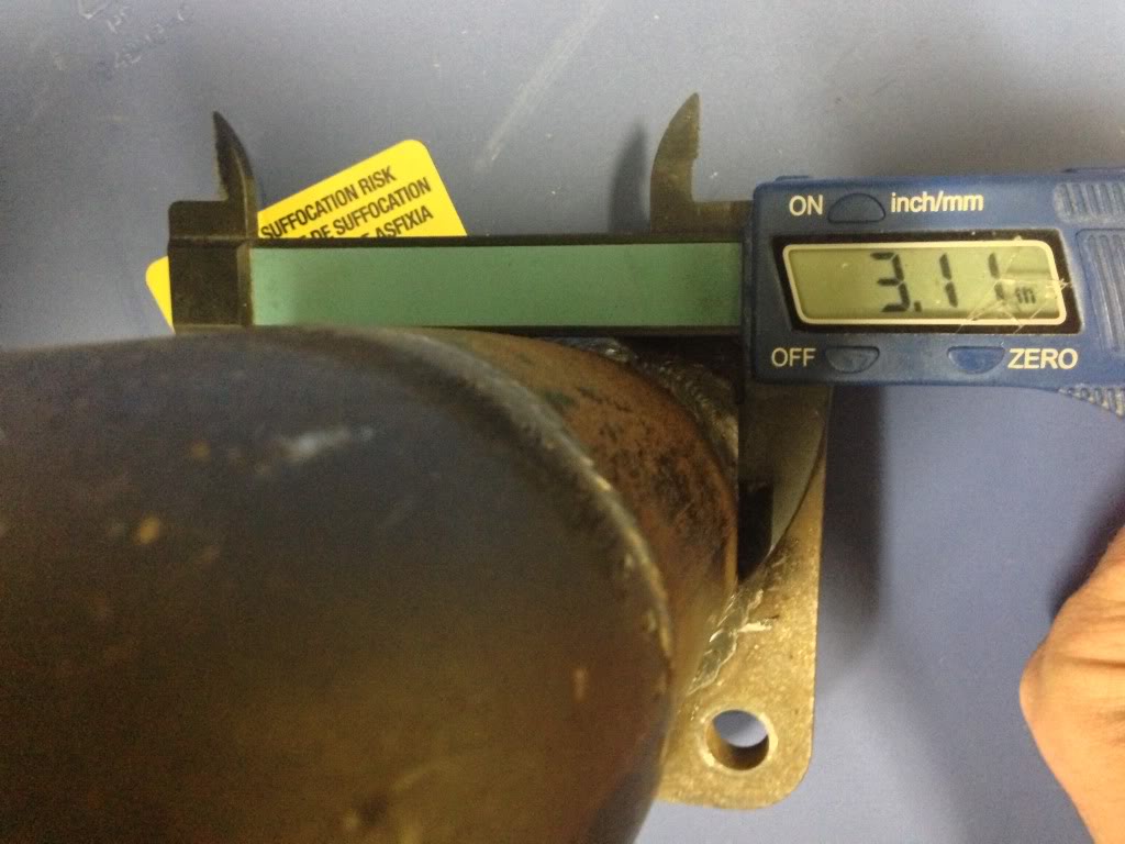

I finally had a chance to measure the hot parts.
T-4 flange

Other end of manifold, where it connects to the crossover.

Runners.

Downpipe. (And my weird *** looking finger. LOL)

Crossover.
