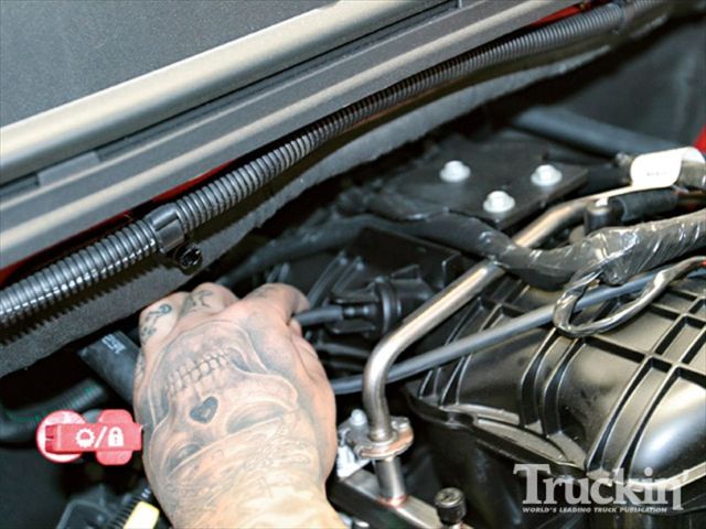

so where is this nipple on the passenger side i see what looks like it could be one if i broke the tip off its about mid way on the passenger side but thats about it?

this is the only place I see to connect the vacuum line too, but I dont see how the cover or whatever is pluggin the hole comes off?

Mine is sealed right there...you would have to drill out a hole if you want to use that. I use the brake boost fitting on the back since I have hydroboost.

I got rid of the evap crap on my truck and used that hole, just tapped for 1/4 npt

You can tee into the brake booster line, that's what I did on the Z28 when it was procharged.
