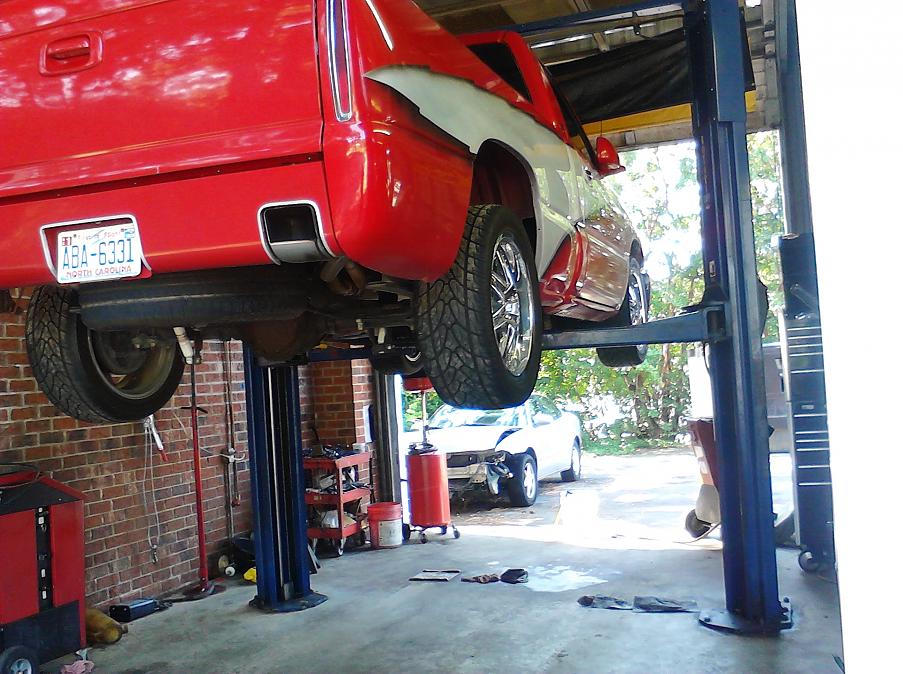

Hey everyone im just really getting into the turbo game with my sierra truck and my biggest question for now is about my 39 mm waste gate. I looked at different posts and didnt see much on it but i see it has two ports for banjo barbs , so my question is do either of theses ports have to be hooked up or can i just leave the barbs in without anything running to them and just go with my springs for pressure control.
here is some starter photo of my project
Attached Thumbnails Wastegate-img_20120922_121038.jpg   Wastegate-img_20120922_121032.jpg   Wastegate-img_20120922_121109.jpg

yea you can just leave unhooked and itll work off of spring pressure only. 39mm might be a little small though

I dont like that wg plumbing either, that coupled with the small gate might cause some boost creep/spike issues. But it may work perfectly idk for sure. Is that an ebay gt45?

ITS FROM on 3 performance 70mm turbo and i got my waste gate from trick and blow off from trick. but setup is a low mount set up

You look like you have a good start going.
